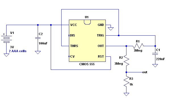

I'm looking to build a simple 1mv peak to peak square or sawtooth generator that will fit in my shirt pocket. I'd like the frequency around 65hz. Should I use a timer or does someone know of something simpler?

I'm just curious why you would want a 1 millivolt signal generator.
Can you just generate a regulator wave, step it down with a resistive divider buffered by an op-amp buffer followed by a AC pass capacitor (to remove offset from the op amp, since 1mV is pretty damn small compared to the mV-order offsets on most op-amps). 65Hz is really slow so I would think a capacitor timer, like a 555 timer would be best.

I want this for a simple ECG simulator that will fit in my pocket. 1mV peak to peak is about the normal size and 65-70hz would be perfect to test telemetry transmitters. The waveform doesn't have to look like an ECG. It wouldn't matter if it was a square wave or a triangle wave.
Pocket sized ECG simulators cost $1,400.00 and that's not an affordable option.

Is that the required bandwidth of an ECG channel? It's about 60 times a normal pulse rate (60-70 beats/min).
Is this a one-off, or do you need a robust design that doesn't require any adjustments? Does it need long battery life? Can you use surface-mount parts, or do you need to use common thru-hole parts?

If I had a unit that is small enough I can deal with it not being adjustable. I just need something simple that will run around 60-70bpm. Battery life is not important. I'm not sure that I would be able to use or solder SMD's with my eyes that are over 50 years old. (c: I'd prefer thru-hole parts.

Sounds like this is an opportunity for a uC project. The size would only be determine by the user interface (leds, buttons) and connectors and the battery. Hmm.... (can you hear the wheels turning?)
Here's a 555 circuit, like Nigel suggested. It should run on a couple of AAA's for months (years?).
There are several CMOS 555 models - TS555, LMC555, ICM7555, ZSCT1555, etc.

That's perfect! Thanx Roff.

You're welcome. Most of the responses here for circuit help (and I do this myself sometimes) are of the form, "you can use one of these IC's". If you're lucky, someone will post a schematic they had laying around, or they found on a web site, of something that you could modify, or they point you to a tutorial. These responses are good if the OP has some circuit design skills, or wants to learn some. Lots of guys, though, and I suspect you are one of them, just want a schematic they can build that will work. They're trying to solve a problem, and don't give a hang about learning how to do it themselves. For these guys, it sometimes only takes 10 or 15 minutes to crank out a simple design, and even simulate it for insurance. This was one of those times.
