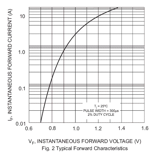

Look at the datasheet, the forward voltage drop varies a lot with the current.
