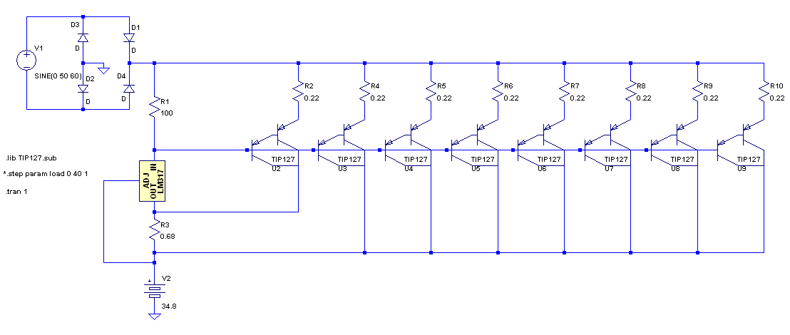

At the moment, I'm trying to make a driver for 40W laser diode (max voltage 2.2V, min current 11A, max current 60A) and I need to make a current regulator to drive it.

For the "fixed current source" I'd go with simple opamp driving paralleled transistors with leads over shunt resistor.
VIN +------------\ />----[ LOAD ]---+---[ SHUNT ]---GND
 [ RES ]          |                 |
    |          [OP-out]             |
    +-----[ OP+ ]    [ OP- ]--------+
  zener
   GND
and then the current trough LOAD would be V(zener)/R(shunt) but since I want to go with 60A I cannot make Rshunt variable and I want to have fine regulation of current between 10 and 60A, and I don't know a pot that will pass trough 60A :D nor one that is in the ballpark of 0.1R or less...
What I figured so far is that putting few (let say 6) BUV48 in parallel and driving them with another buv48 I will have the "driving" power. Using 20x5W 0R47 will get me shunt with low resistance and high power. What I don't know how to do is - how to drive that initial BUV48 to get me the current I want. Mine initial idea was just to use 10K pot as a voltage divider (ends on + and gnd and center to base of transistor) to act as rudimentary voltage regulator, but the problem here is that small voltage changes can cause big jumps in current and that's not what I can afford (as I'm driving expensive laser with it).
Additional problem I didn't even scratch is whether the 2V will be enough to even open transistors ...
Anyone have any ideas?

  1. Several independent constant current regulators. Pros: You can turn them on/off independently and then regulate current in several steps + distribute power loss over several transistors. Cons: Waste lot of energy by heating up the transistors.
  2. Build a Buck converter. Then you can take out fairli high current and low voltage - as oposite to input, higher voltage and lower current.

Thinking out loud...I could see this as a 2.2 volt voltage regulator with huge current capabilities, but you want the regulation on the current aspect. WT? Doesn't your load have a positive resistance?
I have a current regulated source (attached) that would form the basis nicely. Add an op-amp to throttle it down in an analog way when the output gets to 2.2 volts. How to control the amps is a variation on this circuit. Do you want infinite control or chunks of amps that are switchable?

I think the way is a switched Current souce.
Most of the popular chips are designed for voltage regulation.
But you can change that into current regulation, when the Fold Back Pin will get the right voltage driven by current.
If th Fold Back Voltage is specified with 1,76V, so you'll put a 0,16Ohm resistor into ground line.
The resistor will heated with 20W.
That is'nt very effective, so you'll put a little operational amplifier between the shunt and the Fold Back pin.
So you can lower power loss at the shunt resistor.
This solution have 2 little problems.
1. If the line to the laser ist open, the Voltage increases to very high values.
I solved this problem by setting a second voltage divider with an decouple diode at the Fold Back pin.
2. By amplyfy the Fold Back Voltage ( Current ) it is possible the voltage regulator start oszillation.
That can only be tested. Some capacitators at critical points shoud be help to avoid this problem.

I try to explain how a simple switching power supply works:
There are some different methodes how to create an step down converter.
At least the simple ones work with an pulse width signal on the output.
This PWM signal drives a switch ( e.g an P-Channel MOS-Fet )
When the output voltage goes down, the ON time of the PWM Generator will get a little bit longer.
The Fold Back pin get the output voltage information by dividing the output voltage with an resistor network and regulates the pulsewidth of the PWM generator.
The inductor at the output of the switching power supply will hold the current while the switcher circuit is not active. To make the circuit complete there is a diode needed that take the current back to inductor in OFF times of the power switcher.
If the power switcher is on this diode is closed becuse the voltage is reversed at the diode.
If you'll send back this fold back voltage driven by current, you get an constant current regulator.
The problem - When no load is connected at the output there is no current present - thats clear.
So the voltage will exeed until some parts will be damaged.
You'll avoid them by building a second way to the fold back pin of th switching network IC that will stop the voltage overshot at an fixed maximum level.
I think by the high current you need, there are only switching IC with an external power switch rational.
