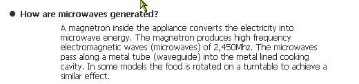

Thats the microwave oven frequency range.
Can you say what you have in mind.?
I think Microwaves run at 2.2GHz, but many wireless apps run at 2.4GHz.

Okay, I stand corrected, but still many wireless devices like cordless phones and such run at 2400 Mhz, my cordless does. I could have sworn microwave ovens were 2.2, oh well I learned something today :)
