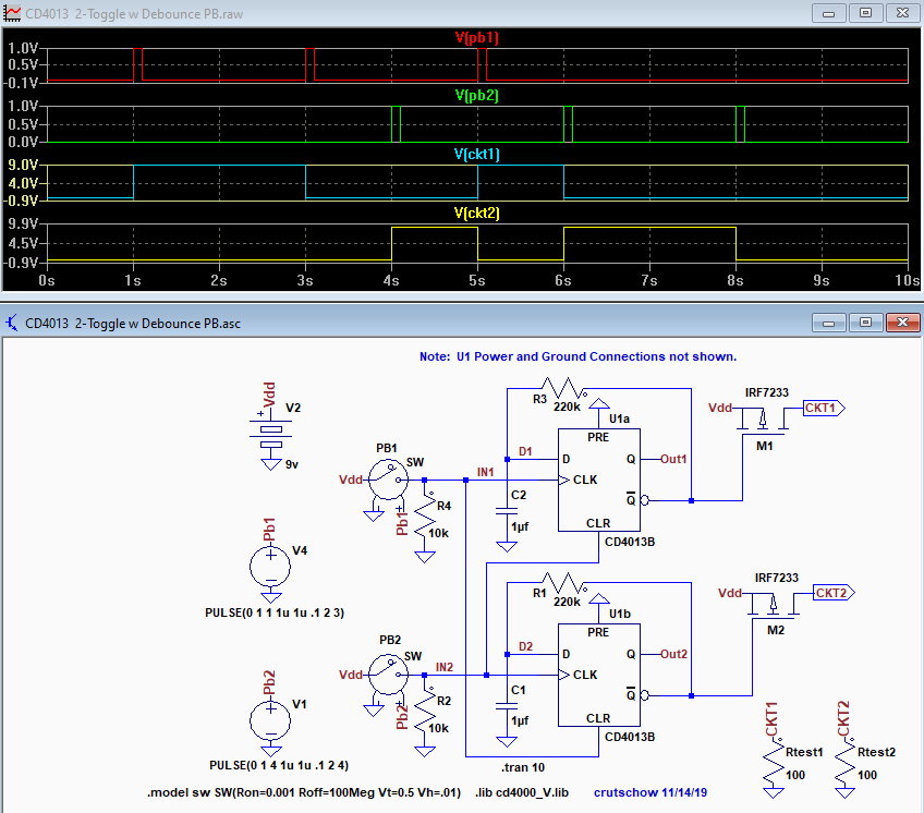

I'm building a guitar effects pedal that has two footswitches handling a separate circuit each but am struggling to understand how to make the switches toggle each other the way I want. Only one circuit must be on at a time or both must be off. I cannot have both on together.
• Switch 1 needs to activate circuit A and break circuit B
• Switch 2 needs to activate circuit B and break circuit A
I think I've managed the above with momentary switches and a couple of latching relays but it means that there is one circuit always on - it just toggles between them. I can't work out how to break both circuits by pressing the currently active switch, ie:
• If circuit A is active - press switch 1 to break circuit A and keep circuit B broken
• If circuit B is active - press switch 2 to break circuit B and keep circuit A broken
I need some help! I'm a bit of a newby to this and want to keep it as simple as possible. The switches are handling 9V to power the circuits, if that helps. It must be done with just two switches. I can't have a third kill-all switch.

Viewed as logic, I think you need two toggle circuits, which change state (on / off / on / off) each time the appropriate button is pressed.
Plus, a cross connection so if one turns on, the other is switched off, if it was on.
Pressing the already-on side again would switch both sides off.
You could do that with a CD4013 dual D type flip flop for the two on-off staged, plus something like a CD4093 schmitt trigger gate to use for switch input debounce and the cross-reset gating.

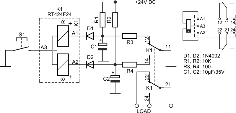

You could also do it with dual-coil latching relays, by starting with an alternate action circuit on-off circuit at each side, then using a feed through an extra relay contact to pulse the off coil of the other half as the relay turns on.
eg. This circuit gives alternate action from a single contact.
It would need a slight rearrangement and a bit of extra logic adding to allow one to be forced off each time the other turns on.
eg. Use a two-pole button at the other side of the coils so the left side is permanently grounded, then add an extra diode to feed the "off" coil of the opposite relay from the "on" side of each.

Below is the LTspice simulation of a circuit that does what you want, using one IC, two MOSFETs, and six passive parts..
It uses CD4013 flip-flops (2 per package) as suggested by rjenkinsgb.
Cross coupling each input to the opposite FF clear input provides both the alternation action desired, plus allowing both to be switched off by a second-push of the same or both push-button(s).
Note that the push-buttons are momentary switches.
V1 and V4 simulate the PB operation.
The resistor and capacitor connected to the D inputs, provide the required debounce function for the mechanical push-buttons.
They prevent the FF from toggling again until after the debounce (RC) time.
I used P-MOSFETS to switch power to the circuits.
They can be just about any that can provide the required circuit current.
That's almost exactly what I was thinking of, is slightly simpler in fact - I was thinking of a gated reset rather than direct clear.
For infor for SAM1, it just needs a debounce between a mechanical switch and the input as shown in Crutshaw's schematic.
This is a typical example, you can use the 74HC14 or CD40106 schmitt inverter.
A switch to ground as shown will generate the positive pulse out, as needed by the 4013 circuit.
No, it already has a debounce circuit, as I explained.
The resistor and capacitor at the D input provides an RC delay to the change in the D input that prevents the flip-flip from changing states more than once during the debounce time.
And debounce isn't needed for the Clear inputs.
Oops.. I missed that - very ingenious!

This comment is really meant for Sam1. But if you "step" on both buttons at the same time it will clear both FF (a bad thing).

clearing the flip flops means they will both be reset so both circuits will be cut off.

I believe my posted circuit meets all his requirements.
