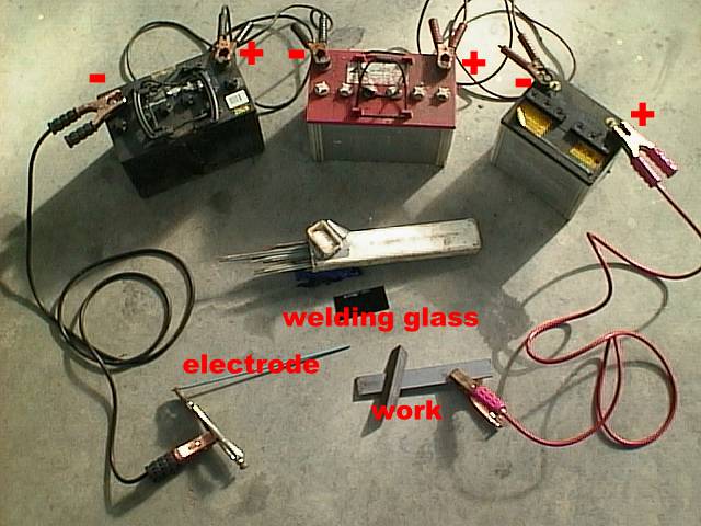

Great use for 2 automotive batteries
See the attachment, I know is a very old trick but sounds great.
I'm dreaming about a nice wheeled box... a beautiful alarm to warn about over-discharging of the batteries... and how to get rid of the hydrogen :rolleyes:
PS: That bold phrase is an insult for the overunity supporters :D
PS2: I think I'll make 3 welds in my life, so buying a decent welder is out of sight.
PS3: i just realized the poor safety that my picture depicts! please use proper protection kids
