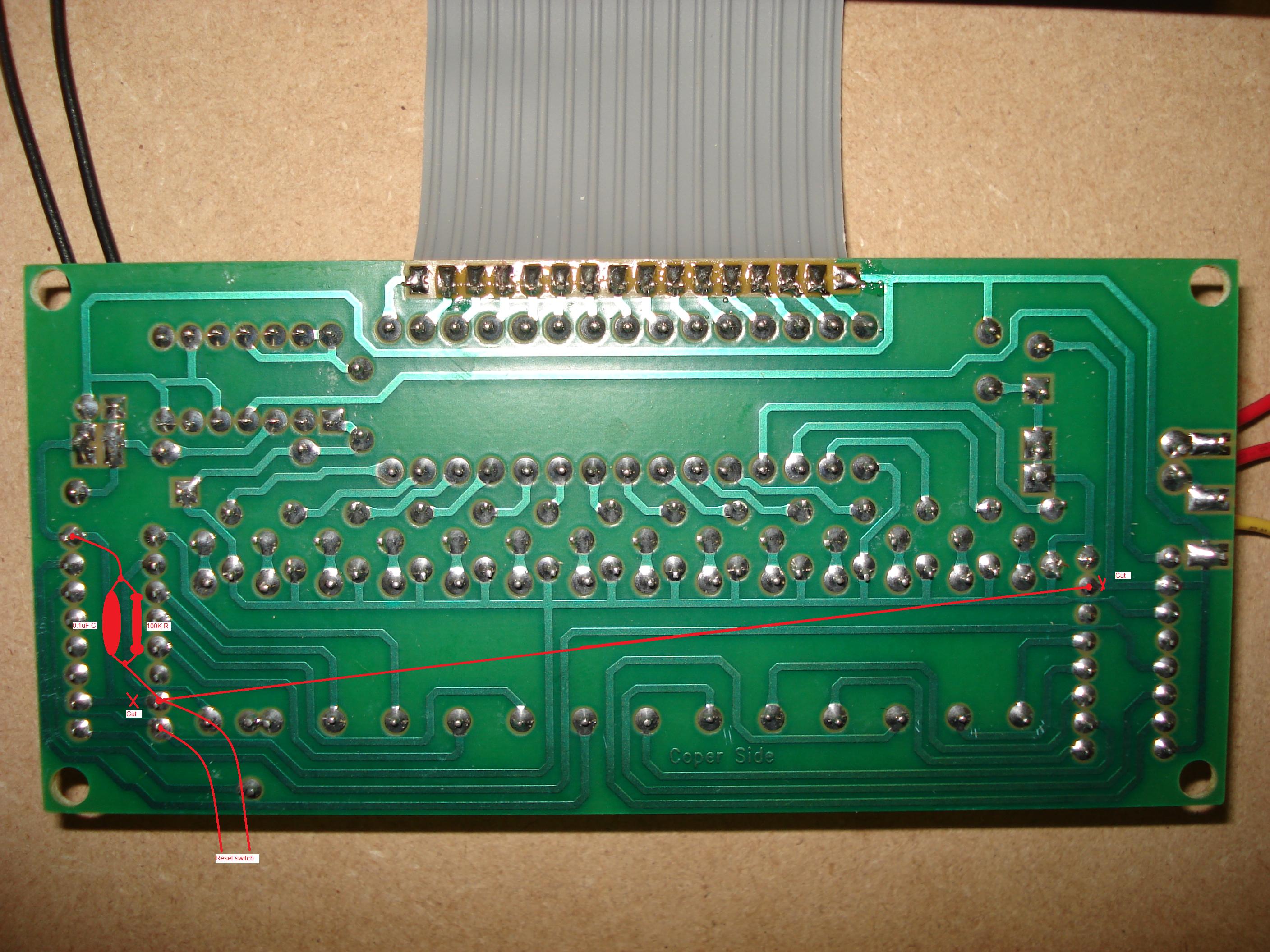

Did you get a schematic of this thing?
Thanks - that looks like exactly what I want to do and I think it's the same core counter I'm looking at. If you could draw a picture of the mods, that would be very helpful!
Here's the marked up photo of the back. I hope it helps.
Thanks for the photo - a picture always helps. And just so I am clear -- the red lines you drew are the wires that I would sodder to the locations noted? And the places you show to cut - how do I cut those lines on the board? And would I buy the resistor/capacitor at a store like Radio Shack? Sorry for all my questions - first time working with something like this and just want to make sure I do it right.
Yes, the red lines are wires. I usually do the cuts with an X-ACTO® knife, but a Dremel® with a burr tip works too.
Radio Shack can supply the parts, or the supplier that you're going to buy the kit from might have them. The values aren't critical. 1K to 100K for the resistor, 0.01uF (10nF) to 0.1uF (100nF) is ok.
