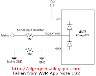

Hi
If i do zero detection using this method will i get 2 interrupt per AC cycle or 1. Interrupt set at Rising edge.
e.g 1 interrupt at 0 degree and another interrupt at 180 degree or only 1 at 0 degree

I hope by mains you mean an input from an AC tranformer, not actually connecting anything straight to mains.
You will get one interrupt, but it won´t be anywhere near zero crossing.
The cited AVR app-note says that there will be one zero-crossing detect per cycle.
It also deprecates the very technique it describes;
This application note shows the user how to implement a zero cross detector with a minimum
of external components. It should be noted that this solution will not give any
galvanic isolation for the microcontroller against the AC mains. The zero cross sense
resistor can be a way for electronic noise to get into the system.
If you show your power supply circuit for the AVR we can come up with a better solution, which will also provide for two interrupts per cycle instead of just one.

Hi, my power supply is from a switching power supply (mobile phone usb charger) to keep things small and compact.
If you connect direct to the AC supply you will get one interrupt very close to zero crossing. If you use a transformer then it will be further away. A 5V transformer will be almost 90 degrees out. If you connect direct to mains then treat the whole circuit as live.
Edit, before anyone get's their knickers in a twist, even 250V through a 1M resistor is safe. A current of 0.25mA never killed anyone. Simply heatshrinking the live side of the resistor should be adequate.
I am not worried about isolation. It is directly connected to AC 220.
How close will i be when it is directly connected to AC220?
See my edit above.
You should be within a few degrees of zero. I don't know the switching voltage of AVRs so can't calculate it.
