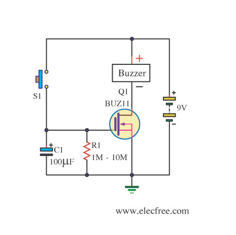

Could you please tell us more about the system. What kind of digital output you have (what is the current limit) and what are the two loads you are trying to drive? How much current do the loads need and are they inductive/capacitive.. what is the system? Give us some chance to help you!
OK, It is a digital output of a PLC controller and it's true there is no capacity to drive to drive the two loads (using Contactors or some other alarming devices -Lamp and buzzer-) the circuit should be an electronic circuit.
there are some loads need to be driven using one output.
two Loads of contactors (on one output) and loads for alarming (Lamp and Buzzer) on another output.
Use a FET switch to turn the loads on and off. You can drive multiple FETs from one output.
Perhaps use your output to drive two FETs to switch the loads?
