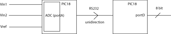

I wish to connect two PiCs together using RS232.
There are 2 inputs, Vin1 and Vin2 (analog). The signals are converted into Digital form and passed it to the next PIC via RS232 connection.
However, on the receiver End, how the PIC distinguish if the signal is coming from Vin1 or Vin2?
Just send two bytes. The first is the channel number and the second is the value. Or if your values are 10 or 12 bits just use the unused bits as a channel number.

I've developed the code using the ideas of u guys. both sensor and receiver are using XTAL 20 Mhz. The baud rate for the rs232 is 9600.
I have made a loop to check the incoming byte continuosly. However, if the loop is rather slow, some data will be missing.
How to ensure the loop is fast enough to catch all the incoming byte? or perhaps we could make sensor send data in slower rate?

Interrupts are the best way to solve this problem. The UART hardware should generate an interrupt when it finishes receiving a byte. You just have an interrupt service routine save the values into a buffer for use in the main part of the program when it has time. You will have to write some low level code to work with the UART instead of the putc and receive command that you are using, but its not that hard.
The master slave protocol I suggested earlier would also solve this problem. To solve the problem of knowing how many channels the slave has you just implement a command from the master that asks the slave how many channels it has.

If you're using the hardware USART you've got all the time the serial data is arriving to do other things, only when a complete byte is assembled in the buffer does it generate an interrupt. You then process the byte and return to what you were doing while the next byte is arriving in the USART.
You've got a great deal more time for your program, using interrupts from the USART, than you have without them.
How fast are you getting data from the sensors? You are sending 3 bytes per sensor reading. At 9600 baud 8-bits & no parity, you are sending a maximum of 960 bytes/sec or 320 sensor readings/sec.
The 20Mhz PIC can easily service 960 interrupts/sec. I have written programs for a 20Mhz PIC that serve interrupts at close to 20Khz rate with code longer than your sample. Even using polling will not tax the PIC. 9600 baud is so slow that in 20Mhz PICs, I use polling to receive and transmit thru the USART while refreshing an LCD. I use interrupts for faster events like generating pulses for a stepper motor driver.
The bottle neck is really the communications baud rate. You should consider increasing the baud rate to cope with the sensor sampling rate.

Does the "putc" function wait for an empty transmit register before writing to it? If not, then that is the reason why you are losing some data.
Another issue is that your receiver program wait for a kbhit() before receiving a byte. Would it result in some bytes being overrun?
After i catch the 1st byte (sync), i will assume the next byte would be id byte, but if the next byte arrives before the receiver able to detect it, the receiver will take the 3rd byte as the id byte.
There are many ways of dealing with your problem, as already suggested using an interrupt routine triggered by the USART would give you loads of time to do what you want (about 1mS for each byte received at 9600 baud - that's about 5000 instructions). There shouldn't be any chance of missing a byte.
Using the USART and polling for the completed flag would still give you loads of time as well, as long as you don't spend more than 1mS on processing between checking the flag.
But even using a software UART would probably give you plenty of time, the stop bit at the end is around 100uS, as long as your processing is faster than that it wouldn't lose anything either - that's about 500 instructions at 20MHz.
As you are generating the signal yourself, you could also add extra stop bits, adding a second one would double your available time to 200uS (assuming a software UART).
I'd bet that getc polls for an incomming char preventing you from doing anything else in that time. Interrupts are the way to go. You might consider making your Ethernet packets interrupt driven too.
You should write your own code for the low level send and receive functions to make them work with interrupts. Writing your own functions might take a bit of time but you won't be tripped up by the unknown behavior of the standard functions.
