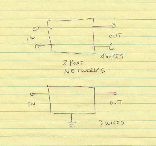

How many ports (or how many connections) into the device you want to get the transfer function of?

Does your network look like either of these?

What other way is there? To theoretically work out it out (if you know the circuit), or (if it's a black box) input lots of data and look for a pattern in the output data.
THere's only so much you can do if all you can see is the input and output data and the rest of shielded from you.
Just sweep the desired frequency range with a sine wave and measure the output with a scope at various intervals to get some data to plot on a graph.
You could also maybe use a white noise generator to feed into the filter network and look at the output on the spectrum analyzer.
I seem to recall one method that used a unit step input, in order to get the blackbox transfer characteristics. Another version was to excite the unknown circuit with a unit pulse .... There was some restriction as to how long the pulse could be with respect to the shortest time constant of the unknown circuit. .... I would have to find a textbook to give more details though.
