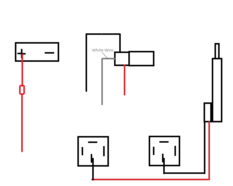

Please bare with me, circuits are very new to me.
I am wanting to wire up an automac chicken coop door that uses a photo switch. I watch a couple YouTube videos. Well mine doesn't work...
I have (2) 4 pole relays (my understanding was that this was to create reverse polarity)
1 12v phot switch with 3 wires (red, black, white) (the white wire is gray in my diagram)
1 linear actuator with 2 wires (red, black)
I have attempted to draw out the circuit, if some could help me finish the wiring I would be most appreciative.
Or tell me how to fix it?
Thank you
James

We don't all have chicken coops. You need to tell us exactly what it is that you want the circuit to do.
The relay contact points on the relay also need some labelling. Some contacts are also missing. a DPDT relay should have 6 contacts (2 to switch the first main current, 2 to switch the second main current, and 2 to control the entire relay.)
Also, please tell us which polarity makes the linear actuator extend and detract.
We also need more information about your photoswitch. There are many types and some types can't work alone.

On the linear actuator if you put red to the negative post and black to positive it extends, reverse and it closes.
I want to the the photo switch to retract the linear actuator when the sun comes up, and extend the linear actuator when the sun goes down

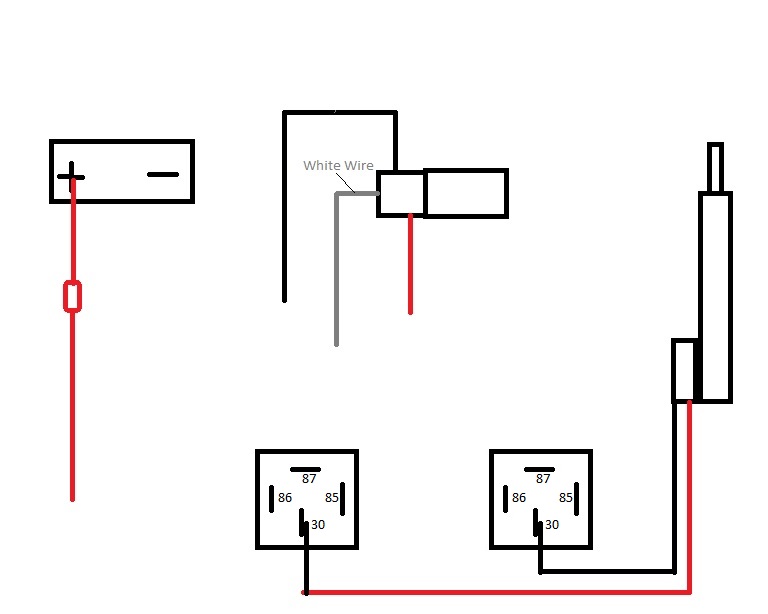

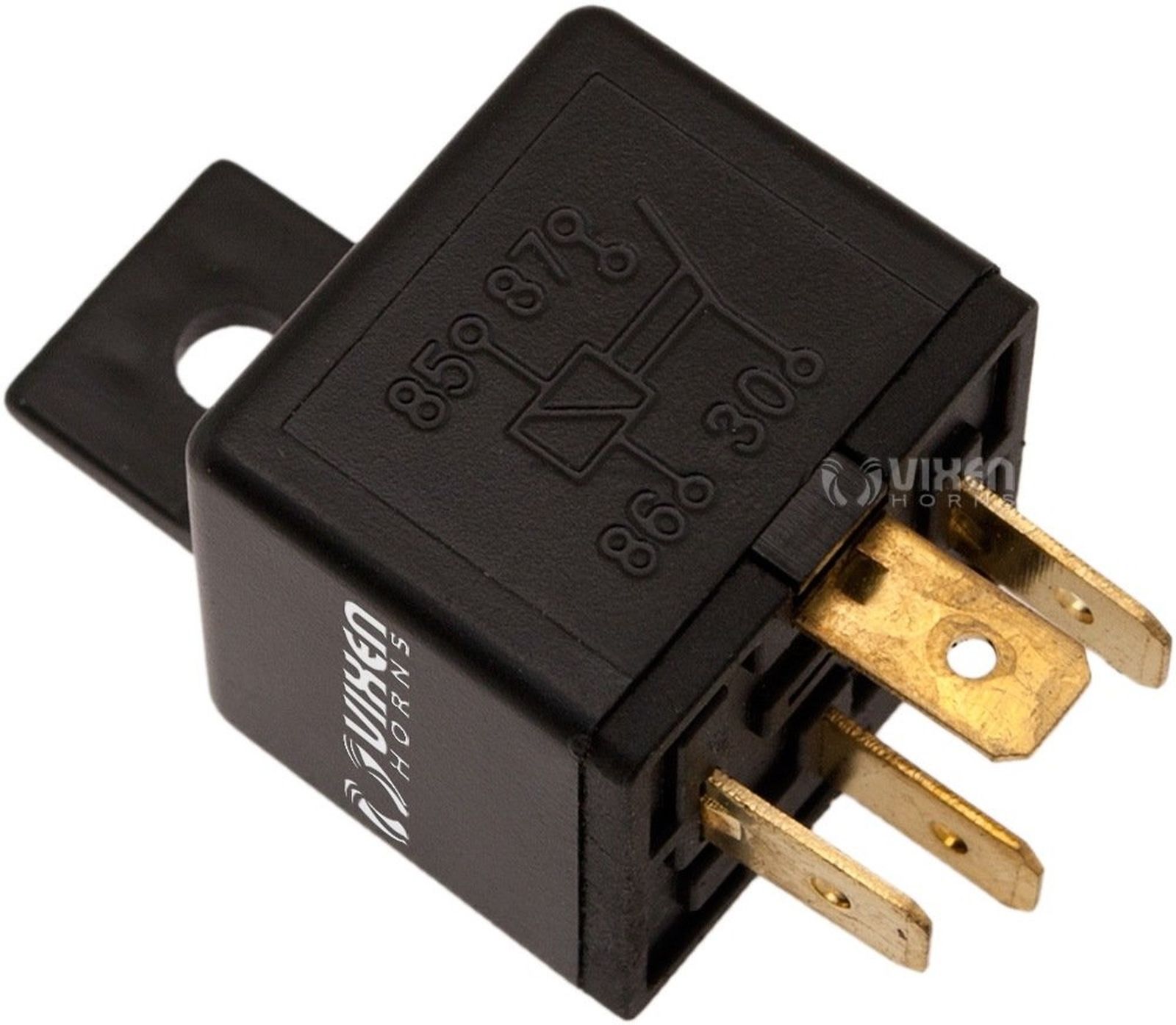

Those relays you have are Single-pole, single-throw relays. You will need four of them to reverse direction through your linear actuator if it only has two wires coming out of it. If it had three wires then you would be able to use the relays you have.
Alternatively, you could use two single-pole, double-throw (SPDT) relays or a one double-pole, double throw (DPDT) relay

I am gonna check and see if I can find one at the auto parts store. If not will this one work?
That should work.
What we're going to end up with is basically something like this:
You may want to grab a 0.1uF X5R or X7R ceramic capacitor and a 2W to 5W resistor that is 1 to 5 ohm while you're at it. To be honest, you could probably get away with 1/4w or 1/2W resistor since this motor only switches twice a day rather than many times per second so the resistor won't heat up much. This is just because whenever a motor turns off it can "kick" and make an arc which can wear down your relays a bit whenever they try to turn the motor off. These two components can be used to help tame things a bit.
We need more information about the photo-switch.
Also, like Ron was saying, we need you to confirm that the linear actuator has a limit switch at both ends so that it stop on it's own when it hits the end (rather than continuing to drive itself and burn itself out). Things get quite a bit more complicated if this is not the case.
