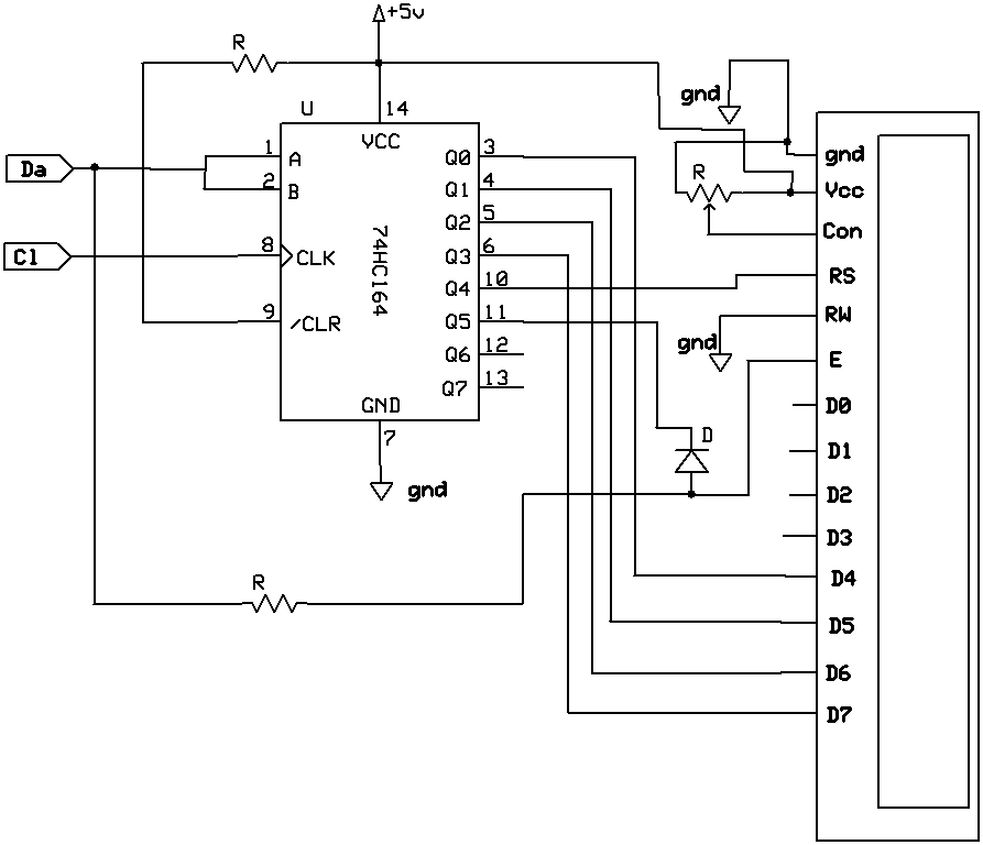

2 wire LCD with a 74hc164 shift register
be80be
I been trying to change this to work on a 16f684 using a 74hc164 for the shift register. With no luck I was using some code that Myke Predko wrote in a book i have 123 pic microcontorller experiments.
I think the delays are not working right or it's FSR It's driving me crazy.

See i get this when I build the line it points to is the delay
Warning[202] C:\2WIRE\2WIRE1.ASM 163 : Argument out of range. Least significant bits used.
Warning[202] C:\2WIRE\2WIRE1.ASM 174 : Argument out of range. Least significant bits used.

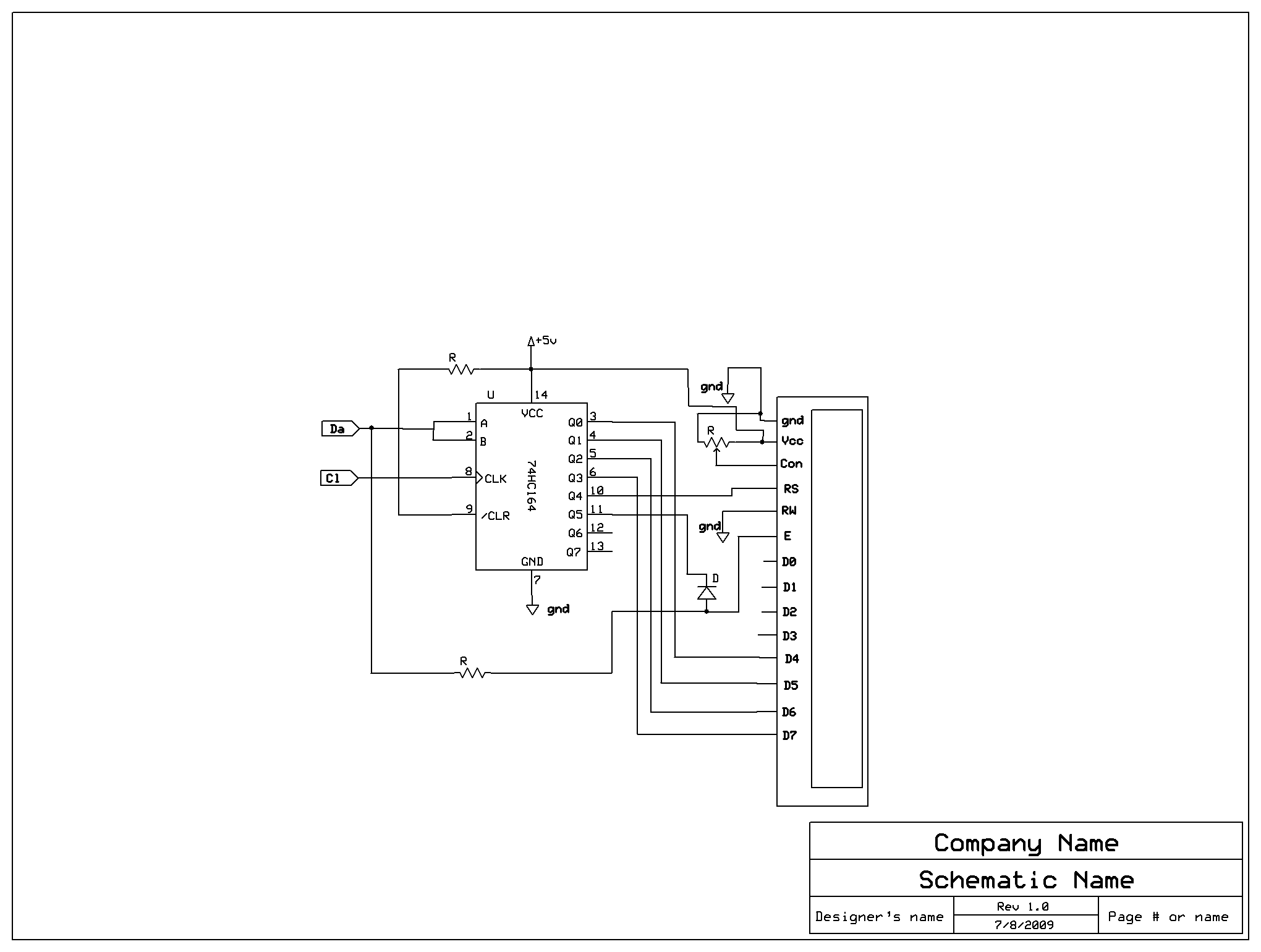

Oh one more thing the lcd comes on and rolls out 8 squares
Oh man i wish this was in C lol if it was i would be able to help more.
1 question.... can you test the shift registers output to ensure the pins are shifting.
It seems to be a delay issue tho. Try creating your own delays and see what happens.
Why use: 256 - ( 160 / 4 )
why not just use:
216
also why: 256 - 0x0E8
why 0x0E8 ? its the same as 0xE8 and in fact just use:
24
try it with those stable values and see if it helps

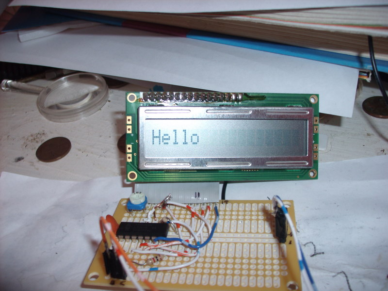

I found one for sure error I missed a pin on the 74hc164.
That sure didn't help.
I'm going to fix that first
I had changed the delay It was where I missed the wire LOL it's alive
What happen is I missed Q4 on the 74hc and put RS on Q5. That's why i want to start using PCB for my boards. To many jumper for things like this.
Your delay numbers worked the code as posted worked and the delays i got from here work

	NOTemp				;  Temporary Value to "NybbleOutput"
	endc
#define	Data  PORTA,0
#define	Clock PORTA,1
	;  Macros
ClockStrobe MACRO		;  Strobe the Data Bit
  	bsf	 Clock
  	bcf	 Clock
 	ENDM
EStrobe MACRO			;  Strobe the "E" Bit
  	bsf	 Data
 	bcf	 Data
 	ENDM
	ORG			0x000		; processor reset vector
  	goto		init		; go to beginning of program
	ORG			0x004	    ; interrupt vector location
init:
	banksel 	OSCCON
	movlw       b'01100000'
	movwf 		OSCCON
	banksel		PORTA
	clrf		PORTA
	banksel		ANSEL
	clrf		ANSEL
	banksel		TRISA
	movlw		b'00000000'
	movwf		TRISA
	banksel		PORTA
	movlw		b'00000000'
	movwf		PORTA
	goto 		Set_LCD
Set_LCD:
  	call   		Dlay5                  ;  Wait 20 msecs before Reset
  	call  		Dlay5
  	call   		Dlay5
  	call   		Dlay5
  	bcf    		STATUS, C              ;  Clear Carry (Instruction Out)
  	movlw  		0x03                   ;  Reset Command
  	call   		NybbleOut              ;  Send the Nybble
  	call	 	Dlay5			;  Wait 5 msecs before Sending Again
  	EStrobe
  	call	 	Dlay160		;  Wait 160 usecs before Sending the Third Time
  	EStrobe
  	bcf    		STATUS, C
  	movlw  		0x02                   ;  Set 4 Bit Mode
 	call   		NybbleOut
 	call	 	Dlay160
  	movlw	 	0x028			;  Note that it is a 2 Line Display
  	call	 	SendINS
  	movlw	 	0x008			;  Turn off the Display
 	call	 	SendINS
  	movlw	 	0x001			;  Clear the Display RAM
  	call	 	SendINS
  	call	 	Dlay5			;  Note, Can take up to 4.1 msecs
  	movlw	 	0x006			;  Enable Cursor Move Direction
  	call	 	SendINS
  	movlw	 	0x00C			;  Turn the LCD Back On
  	call	 	SendINS
  	clrf	 	FSR			;  Output the Message
OutLoop
  	movf	 	FSR, w			;  Get the Offset to Output
  	incf	 	FSR
  	call	 	Message
  	iorlw		 0			;  At the End of the Message?
  	btfsc	 	STATUS, Z
   	goto	 	Loop			;  Yes - Equal to Zero
  	call	 	SendCHAR		;  Output the ASCII Character
  	goto	 	OutLoop
Loop				;  Loop Forever when Done
  	goto   		Loop
;  Subroutines
Message				;  Message to Output
  	addwf	 	PCL			;  Output the Characters
  	dt	 		"Hello", 0
SendCHAR			;  Send the Character to the LCD
  	movwf	 	Temp			;  Save the Temporary Value
  	swapf	 	Temp, w		;  Send the High Nybble
  	bsf	 		STATUS, C		;  RS = 1
  	call		NybbleOut
  	movf	 	Temp, w		;  Send the Low Nybble
  	bsf	 		STATUS, C
  	call	 	NybbleOut
  	return
SendINS				;  Send the Instruction to the LCD
  	bcf	 		STATUS, C		;  RS = 0
  	call	 	NybbleOut
  	bcf	 		STATUS, C
  	call	 	NybbleOut
  	return
NybbleOut                ; Send a Nybble to the LCD
     movwf     NOTemp    ; Save the Nybble to Shift Out
     swapf     NOTemp    ; Setup to Output to the High Part of the Byte
     movlw     6         ; Clear the Shift Register
     movwf     Dlay
NO2Loop1
     ClockStrobe
     decfsz    Dlay
     goto      NO2Loop1
     movlw     5          ; #### - Now, Shift out the Data with the "RS" Bit
     movwf     Dlay
     bsf       Data       ; Put out the Gate Bit
     ClockStrobe
NO2Loop2
     bcf       Data       ; #### - Clear the Data Bit (which is the Clock)
     btfsc     STATUS, C  ; #### - If the Bit to be output is a "1", Shift it Out
     bsf       Data
     ClockStrobe
     rlf       NOTemp     ; #### - Shift the Next Bit into the Carry Flag
     decfsz    Dlay
     goto      NO2Loop2
     EStrobe              ; Strobe out the LCD Data
     return
Dlay160                         ;  Delay 160 usecs
  	movlw  		256 - ( 160 / 4 )      ;  Loop Until Carry Set
  	addlw  		1
  	btfss  		STATUS, C
   	goto  		$-2
  	return
Dlay5                           ;  Delay 5 msecs
  	movlw  		4                      ;  Set up the Delay
  	movwf  		Dlay
  	movlw  		256 - 0x0E8
  	addlw  		1
  	btfsc  		STATUS, Z
   	decfsz		Dlay
    goto	 	$-3
  	return
  end
Thanks Burt! They worked, looking more closely at my circuit I noticed that the diode was inserted backwards. Now works like a charm :)
