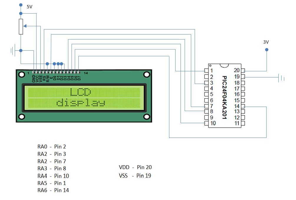

2 x 16 lcd
nusry
are these pin connections ok?
PIC24F04KA201
What is the different between 4bit communication and 8bit communication?
are these pin connections ok....
PIC24F04KA201
Using 8 bit wide data to the LCD means that a full 8 bit byte can be written to the LCD controller.
With 4 bit wide data, the 8 bits of data are written in two successive 4 bit bytes.
The 8 bit is overall faster but requires 8 PIC pins, the 4 bit uses only 4 PIC pins.
OK.?
