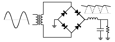

I have been searching for a way to make a simple 20 to 40 Volt power supply that can supply several amp's, for the ZVS Flyback Driver. If I can get AT LEAST 20V and AT LEAST 2 Amps, Then I can be happy :)

Oh, then that's easy. Just make a bridge diode rectifier with 4 large diodes (or buy one component that has them all together, though power levels may be lower), get a big...REALLY big, like 1000uF or even 4700uF capacitor, and just choose a transformer that will step down the 120VAC mains to a voltage low enough that the voltage you want will be created by the bridge rectifier+capacitor.
You can only pull 1500W max out of a wall socket though (and efficiency is not 100%, so 40V@10A is out of the question, but 2A is very possible at any of your voltages.
40v at 10 amps is only 400 watt - easily achievable from a decent toroid. You would also need some capacitors waaay bigger than 1000uf (read as 20,000 uf upwards depending on how much ripple you can live with).

Just buy a transformer of the voltage and current you want, toroids of various voltages are freely available, and quite reasonable cost. Then a large bridge rectifer, and some nice large electrolytics.

It's just a transformer feeding into a diode bridge which feeds into a capacitor that sits in parallel with the load. Whether the transformer is toroidal or not doesn't really change the schematic.

How is a toroidal PS any different from a PS that uses a regular transformer? A toroidal PS is just a PS that uses a toroidal transformer- no difference in the wiring, just the specific type of component being used.
Odd...the link works just fine for me. See if this specific image from the link works. THe inductor is optional:
http://hyperphysics.phy-astr.gsu.edu/hbase/electronic/ietron/rectbr3.gif
