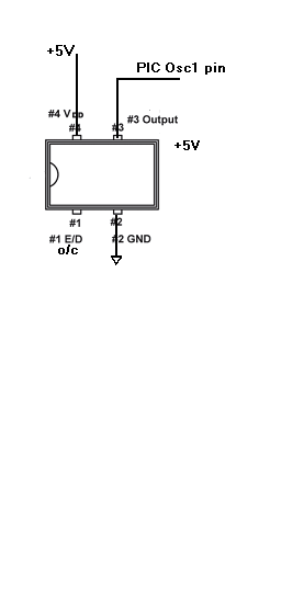

I bought some materials for the assembly of the boards and needless to say, 20 MHz oscillators were part of the order.
Main board No2 has a 20 MHz crystal. Two connections only are indicated on the circuit diagram.
The crystals I bought are manufactured by Fox and are type FS02 B 20.000 511. They have have four connections and are contained in a rectangular plastic enclosure. The crystal in the photo in Nigel's Tutorial is different.
I have looked at the data available to me and can't arrive at a decision as to how the crystal should be connected or if indeed it is unsuitable and another type of component should be used.
Can any one advise me please.
JMcG
Sounds like you got yourself an oscillator and not a crystal.
The FSO-2 series datasheet is here:
https://www.electro-tech-online.com/custompdfs/2008/07/fso.pdf
It is possible to use it by connecting it's power (pin4) to 5v and ground (pin2) then the output (pin3) goes to your PIC OSC1/CLKIN pin which is pin16 on a pic16f628.
Do not connect anything to the PIC OSC2/CLKOUT pin. (unless you want to use the 5Mhz clock output for something)
Also, as shown in the FSO-2 datasheet, it needs a 0.01uF bypass capacitor near the oscillator power pins and do not connect it's pin 1 (E/D) to anything.

hi Joe,
If you have a 4pin DIL 20MHz osc ic, it would be OK to use that in place of a standard 20MHz crystal.
Connect it as 'picasm' describes
You dont need the external low value caps.:)
EDIT: added a gif.
