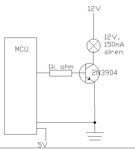

Does hFE tells how many times is the collector-emitter current greater that base-emitter?
I need to control 12V, 150mA siren connected to the PIC MCU putput and I thought I would use 2N2904 NPN and connect like diagram shows. I am not sure if I choosed the right transistor.

The base current must be 1/10th the collector current for the transistor to saturate.
hFE is used for a linear amplifier transistor that has plenty of collector to emitter voltage.
For a base current of 15mA the resistor should be 270 ohms.

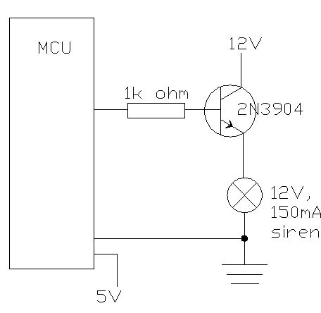

I corrected the diagram. Is it OK now?
capture-jpg.36593
15mA is too much for PIC MCU, or it is absolute maximum. I need other NPN then, the one that has higher base/collector current ration, at least 3 times higher - can you help to fing some?
How do you get the 270ohm? Did you use (5V-1V)/15mA. Where in datasheet you get base/current "ratio"? Need to understand that I won't need to aks every time.

The 2N2904 is a PNP transistor and will not work in this circuit. As noted before, common collector is not the best way to drive this load.
Your new diagram uses 2N3904, which at least is NPN. Although it is rated for 200mA, observe that all of the characteristic curves stop at 100mA because its gain all but disappears above that level.
The datasheet for the 2N3904 and most little transistors have a written spec called "Collector-Emitter Saturation Voltage" and it shows the base current as 1/10th the collector current.
capture-jpg.36593
That's not the best approach. You need to understand how bipolar junction transistors work, then you'll understand that the above isn't what you need.
As I understand it -- and the gurus will correct me, I don't doubt -- BJTs can either be "off", operate as amplifiers, or operate "fully on". To act as a switch, that is, maximizing current through the driven device, and minimizing the voltage drop across the collector/emitter and thus reducing heat, you need to run the BJT in the "fully on" or "saturation" mode. Essentially saturation occurs when you can't get any more current into (out of) the collector with additional base current.
To ensure a BJT is in saturation the rule of thumb is to force 1/10th the desired collector current into the base by selecting the base resistor value. As mentioned there's usu. a voltage given in the datasheet as to when the transistor just enters saturation. But you want to push it well beyond that point to ensure it doesn't come out of saturation (e.g., your wall or battery voltage sags and drops Vcc, or resistor is a little out of spec or tolerances on the BJT, or I donno what)
You may know about the key relationships. Ie (emitter current) = the sum of Ic and Ib. Also, Vbe = 0.7V for any silicon BJT. With those two facts, plus ohm's law, and kirchoff's voltage law you can figure out everything else as you may have surmised.
The 270Ω resistor was figured out using both of these, etc. V = IR, Vcc - Vbe / Ib = R, 5V - 0.7V / 15mA = 286Ω 270 would add a little extra current, no problem.

The max allowed output current from a PIC output is 25ma so only 15mA into a 270 ohm resistor is fine. The PIC output goes up to 5V only when it does not have a load current. With a current of 15mA its output voltage is about 4.75V. The base-emitter voltage of the transistor is 0.7V so the voltage across the 270 ohm resistor is 4.05V which produces 15mA.

The 2N3904 characteristic curves, including the one for saturation, conveniently stop at 100mA like I said.
All of the charts show remarkable deterioration of performance as 100mA is approached. At 150mA I would expect nothing but disappointment.

PS I still don't understand why first of my diagram won't work. Isn't same if syren is connected to the emitter or collector? Why current won't flow if syren is connected to colector? The problem is that I only have + wire leaded to the syren. The negative wire is simply syrens housing connected to car's body. So how can I connect syren by second diagram? Do I need PNP then?
Your first diagram (with siren in the emitter) could only ever supply 4.3V maximum to the siren, and the transistor would get red hot and die. You need an NPN with the siren in the collector for it to work - this is 'sinking' current. If you want to 'source' current, you need two transistors (NPN and PNP), check my PIC tutorial pages.
A 2N4401 transistor has a max current rating of 600mA and works very well with a current of 150mA. Its datasheet also lists its max saturation voltage loss when its base current is 15mA and its collector current is 150mA.
The datasheet shows its ß as 100 to 300 at 150mA when it is a linear amplifier with a collector to emitter voltage of 1.0V (when it is not a saturated switch). Then its max base current is only 1.5mA.
Right, so use a 2N4401 or a 2N2222 -- something with higher current rating.

The first diagram will sort of work, but not optimally. Because emitter current is a sum of both collector and base current, placing the load on the emitter limits both base and collector current. But you don't want to limit base current or you can't select a current to drive the transistor into saturation.
When you put the load on the collector and connect the emitter to ground, then the base current can be anything you want, which is what you need to be able to force the transistor into saturation.

As already said, if you need to source current, you'll need a PNP transistor. But as your siren doesn't use the same supply as the PIC, you'll need an extra transistor to do the magic (to turn the PNP transistor ON, for the PIC alone would not handle it).

Driving the load with an emitter follower, when the base can only go to 5V, will limit the voltage across the load to ≈4.3V. Not only is this not optimum, it probably won't work.
