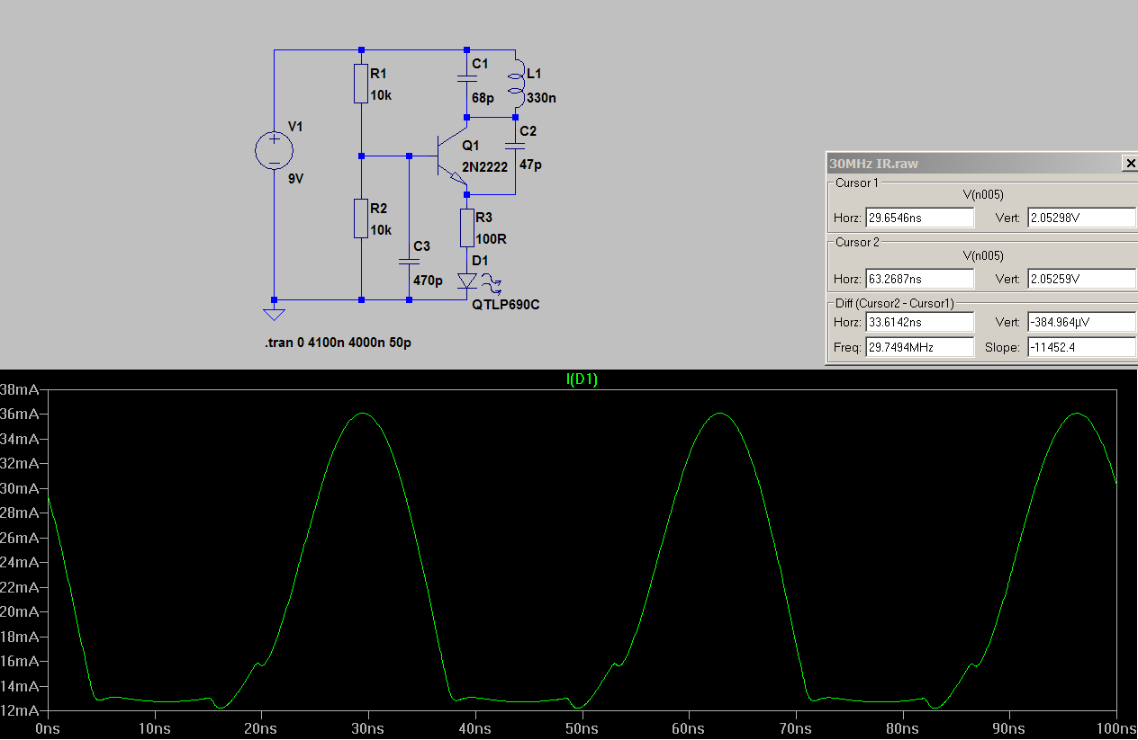

Here's how I'd do it.
I've never built it but it works in LTSpice.
You'll need to build it on a small PCB, don't even try breadboarding this because it won't work.
It might work because the LED never turns off, it just gets dimmer. LTSpice doesn't have an IR LED model (that I know of) so I used a red LED.
This circuit will oscillate at about 30MHz and isn't very stable. Build it in a screened enclosure (e.g. a metal box) to minimise RF emissions.

i got your circuit hero999 thank you so much i ll try that circuit but
is there any ic for worrking range 30 or 20 mhz with sinewave output. and can i design this oscillator with 74hct4046a IC? there is vco inside the IC but how can i use?

There are many ways of designing a 20MHz to 40MHz oscillator, I just posted the simplest method.
Change the values of C1 and L1 to alter the frequency. The value of C2 will also need changing if you change the frequency significantly.

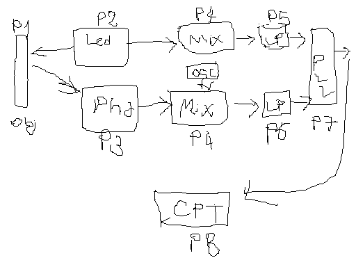

i just though maybe easy way i can do it with ic due to i need stable oscillator. i need sinewave because i ll modulate signal from output of receiver. i m not sure which way easy and minimum complicated. i can use xtal oscillator but problem is stabilite.
any suggestion for oscilaltor?
thank you
hi again
i just quick drew sorry for messy design.
p1: object which reflects ir led beam
p2: ir transmitter 20 mhz with sine wave
p3: photodiode detector with op amp amplifier
p4:mixer which is modulated output of op amp and driver circuit
i forget osc. which is referance or carrier signal for mixer
p5 and p9: low pass filter to get low frequency fc-fo
p6: xor input for phase differences between led driver and phootodipde amplifier output
and finally computer interface with a/dc
final part not important
i dont use microprocessor only for interface part i ll use.
all design will be analog.
if you need further explanation i could give more detail.
thanks for help
