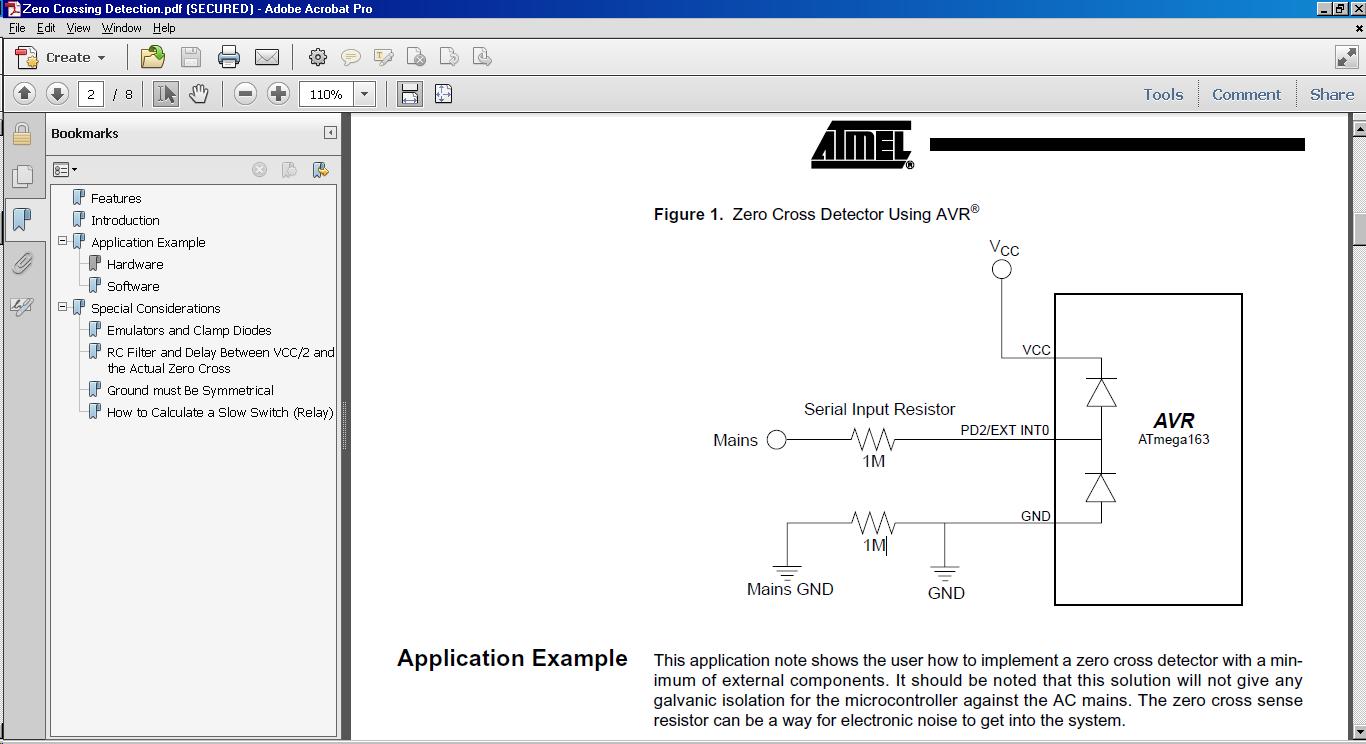

according to the notes in AVR document, lets say i connect the mains to my uC.
My test setup: Laptop usb powering my uC and UART connection using serial-to-usb connection to another port on my laptop to uC for debugging.
So should i remove all other connections before connecting the mains or is it ok for test purpose if i am careful.
On safety grounds I would advise the use of an isolating transformer to derive the mains input signal.
My final design will not have any isolation, so i want to run from mains and see the output in my terminal program.
SO i guess i am good to go.:) i have to be super careful;)
