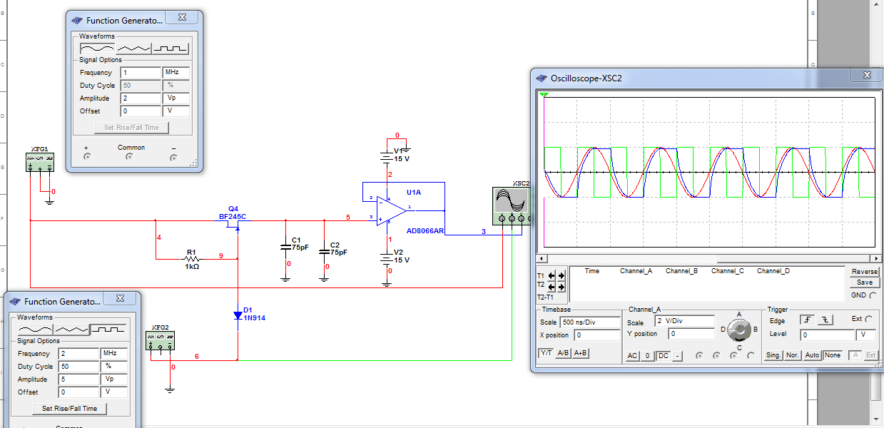

MisterT, thanks for your suggestion. But my part is just on doing the sample and hold circuit, so ADC is none of my concern. Thanks again though. Attached below here is the circuit that I'm working on for the past few days. The problem is,I can only reach around 1Mhz with this circuit. Also, I'm using high speed FET and Op-Amp. The capacitor is polypropylene type and the clock acts as the sampling frequency.Theoretically, 22Mhz is not a problem. Help me please.

There are op-amps that have shutdown function. When the op-amp is in shutdown mode its output is in high-impedance mode. I don't know how fast they can be switched, but with that kind of op-amp you might be able to eliminate the mos transistor switch in your design.

Your instructor seems to have little appreciation for the difficulty of doing a 22MHz sample and hold. It's not the type of project that should be assigned for classwork. It requires switches with very low gate capacitance, a low value sampling capacitor, and careful layout. Your best bet would be to find an IC S&H that can do the job.

I'm not sure I can help without spending hours designing, and even then you would learn very little. I also doubt your instructor would believe that you did the design work.
OK, I whipped up a preliminary design that will handle an input signal of ±0.5V max. I simulated it, and it looks pretty good.
What would you do with it if I posted it? Do you actually have to build it? Simulate it? Just turn in a schematic?

I have it sampling at 5MHz. It will run faster - not sure how much.
I think you might have a problem getting some of the parts to actually build it. For example, I used eight 1ps70sb10 Schottky diodes, made by NXP.
Do you have LTspice, and do you know how to use it?
Are you supposed to design this yourself? If so, how are you going to explain how you designed this? I'll guarantee you there are very few college students who would design a sample and hold using the approach I used.
Perhaps you should consider using an analog switch like 74HC4066. I'm not sure if they would work well at 5MHz, but if so, it would be a heck of a lot simpler than the approach I took.

Roff, I've tried to replace the FET using 4066 quad analog switch. It can reach 5MHz but the input output voltage range is only +-0.5V due to the IC characteristic. However what I want is in the voltage range of +-2V, is there any solution?
