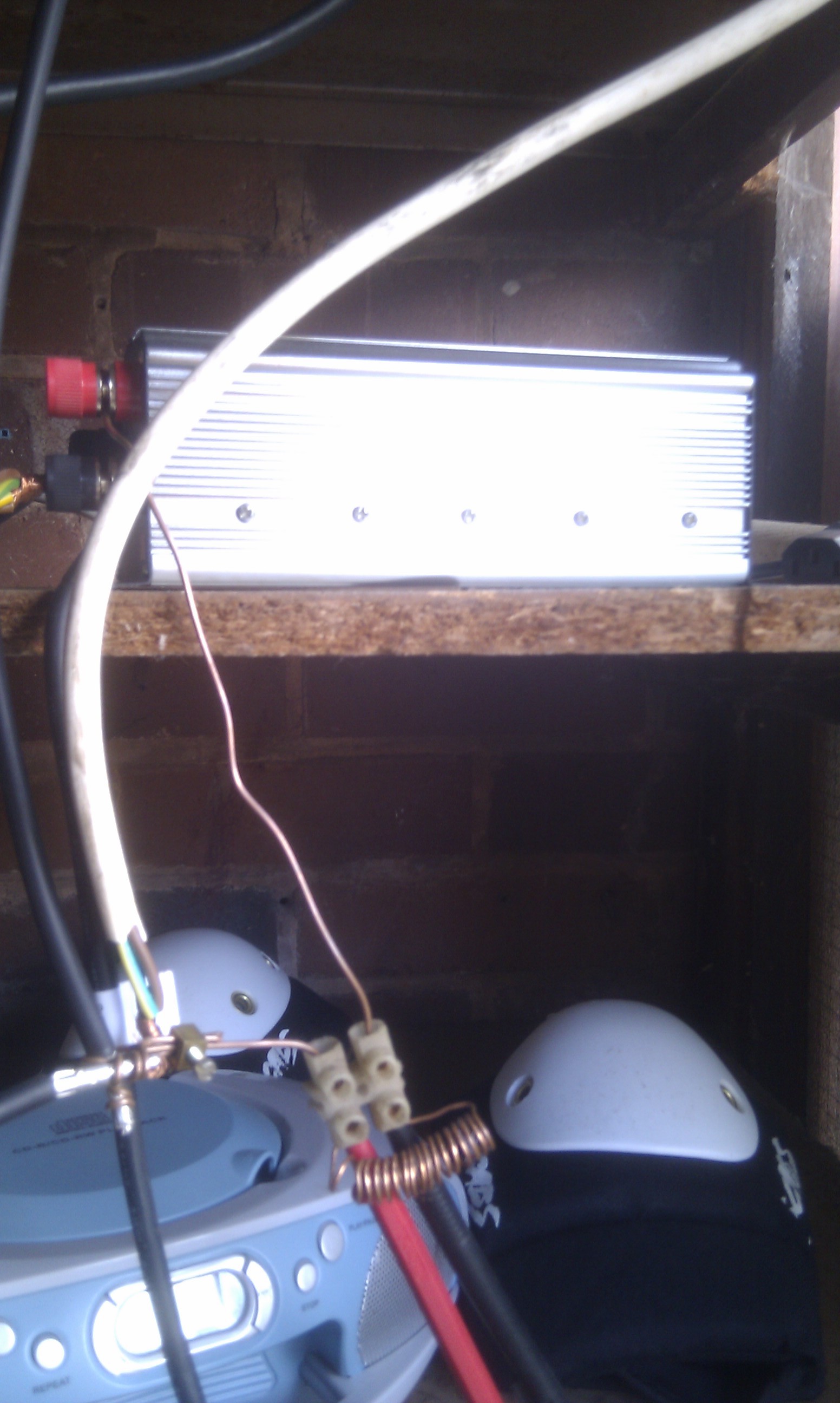

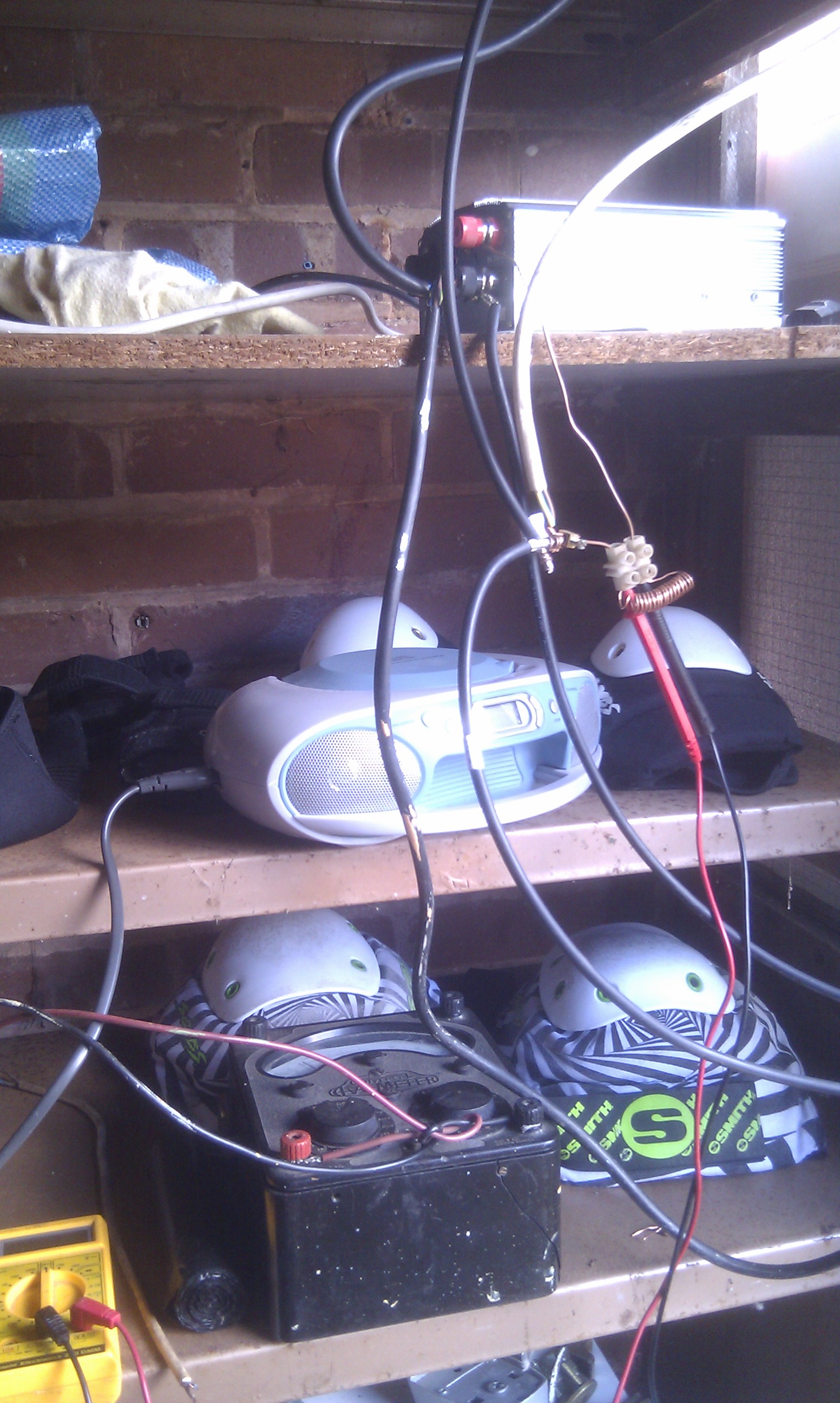

How about som pics for us? :D

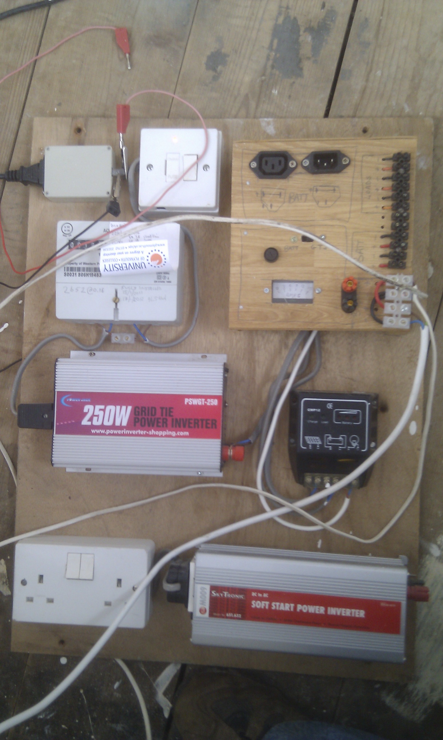

For those interested in a picture... Attached is the board I made up for the solar grid tie at my parents house before I moved out. The array was only 145W of various panels but it could charge lead acid batteries or connect to the grid (manually switched). It had a standalone inverter for when there's a power outage, but typically it never happened.
