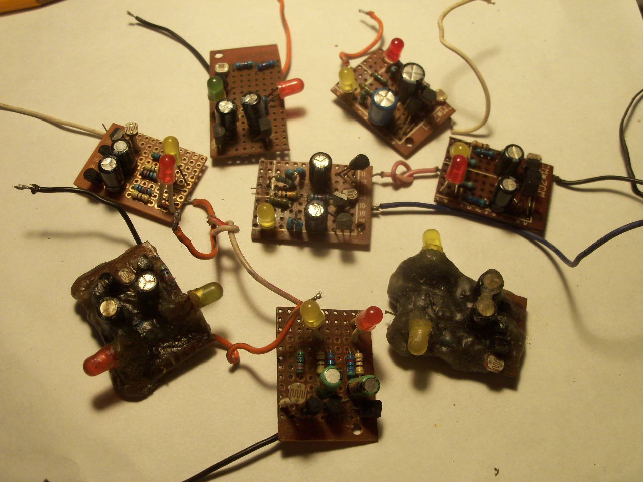

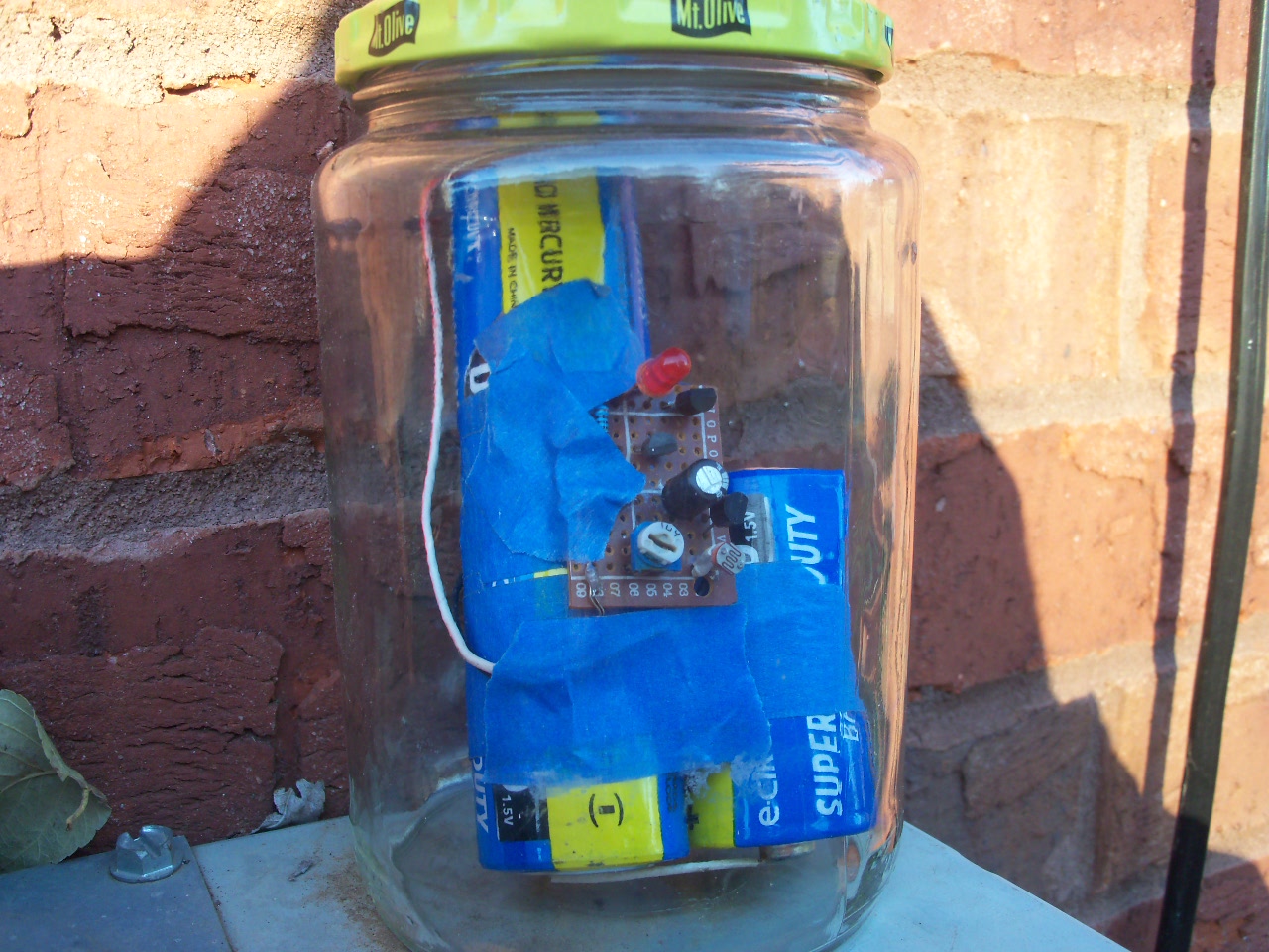

I looked for solar cells to charge AAA eneloop batteries but prices are very expensive and not sure my LED flashers get enough sunlight to charge 2 batteries in series. Solar cells are .5v each. 2 batteries are 3.2v I probably need 4v to charge 2 batteries. Solar cells I find for sale never have amp rating? Even if I use small 1" square solar cells 8 will not fit inside a glass jar to prevent them from getting rained on unless I use larger jars. We have an average of 250 days of rain every year. Our humidity is too high also sometimes my transistor wires rust away in 6 months and LED wire rust away in 6 months also. I have tried dipping PC boards with parts in, candle wax. bees wax, paint, nothing is stopping wires from rusting away it only slows it down. I put PC boards & batteries in jars in the house in AC where humidity is lower but still wires turn to rush in 6 to 12 months. Often jars have a teaspoon of water inside after being out side for 1 week.

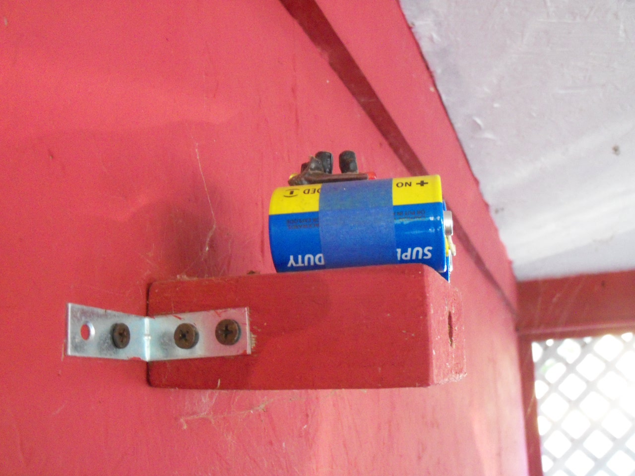

It is interesting only parts inside jars rust. I have several PC boards just setting out in the open air where they can not get rained on and wires NEVER rust. PC board on car port never gets rain unless we have 60 mph wind but parts dries out and never rusts. PC boards under eaves of the house roof are about 12" from getting rained on and never rust. Jar has something to do with making wires rust. PC board in a jar on the dash of my vehicle rusts but remove it from jar set PC board on dash no rust. ?
I think I might fill jars with high voltage oil, battery & PC board under oil should be ok.
Circuits work good when 2 new batteries are 3.2v but stops working when at 2.7v. When I add 1 more used battery 1.4v + 1.4v + 1.4v = 4.2v circuit works good and runs for another 9 months. When voltage drops to 2.7v again circuit stops working. 4 low batteries .9v each = 3.6v circuit runs about 1 month and stops. Waste of time using batteries with less than 1v. I sure get my moneys worth out of these batteries by connecting them in series until they finally die.
If I buy better batteries the batteries will out live the rusty wires on the PC boards. Jars are causing rust on wires. I put several packs of water adsorbant in the jars then I fine the packs setting in a pool of about 1 teaspoon of water. TN humidity is 100% most of the time & assemble in AC low humidity room is not helping.
PC board in pic on red color wooden block near ceiling of car port has been her 2 1/2 years, same PC board with no rusted wires. Put this PC board in a jar or zip lock plastic bag LED wires & transistor wires will be rusted away in 6 months.

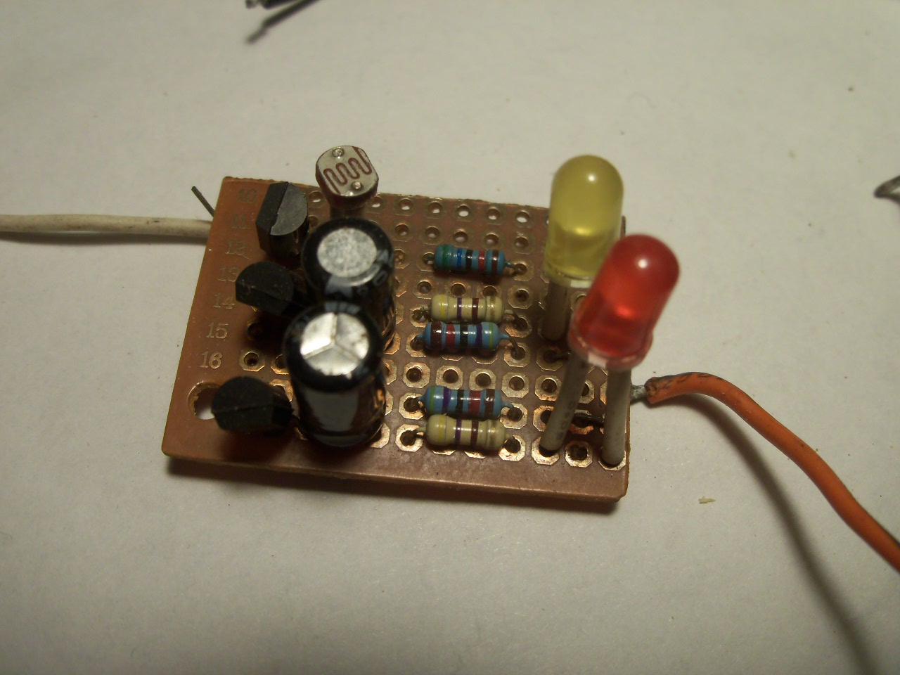

First pic is new PC board I put board and jar in hot kitchen oven 130 degrees F 30 min opened door assembled them inside the oven. LOL. So far so good no water collecting in the bottom of the jar, it has been outside for 3 weeks, this is a 1 LED circuit all the others are 2 LED circuits.

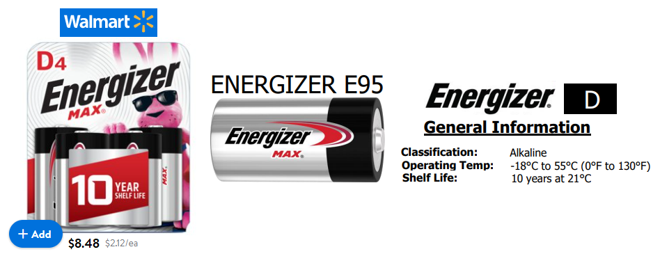

Your photos show very cheap poor quality Super Heavy Duty batteries from China. Who knows what is in them? Of course they freeze.
Energizer make high quality batteries that do not cost much and are rated for 0 degrees F and a storage time of 10 years.

Almost six Energizer AA alkaline batteries weigh as much as one D cell and produce the same mAh when in parallel, but six AA batteries cost twice as much as one D cell.
The cheap Chinese Super heavy Duty batteries have no datasheet so nobody knows how weak they are.
