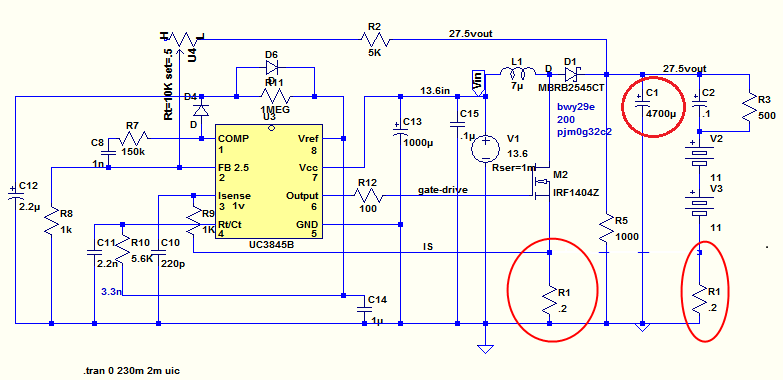

I am getting a new wheel chair and in preparation for a planned trip, I'm building a charger for it that gets it's power from the 12 volt charging system of my motor home. The sims are basically the same except for the capacitors in parallel with the load, the4r 24 volt battery system.

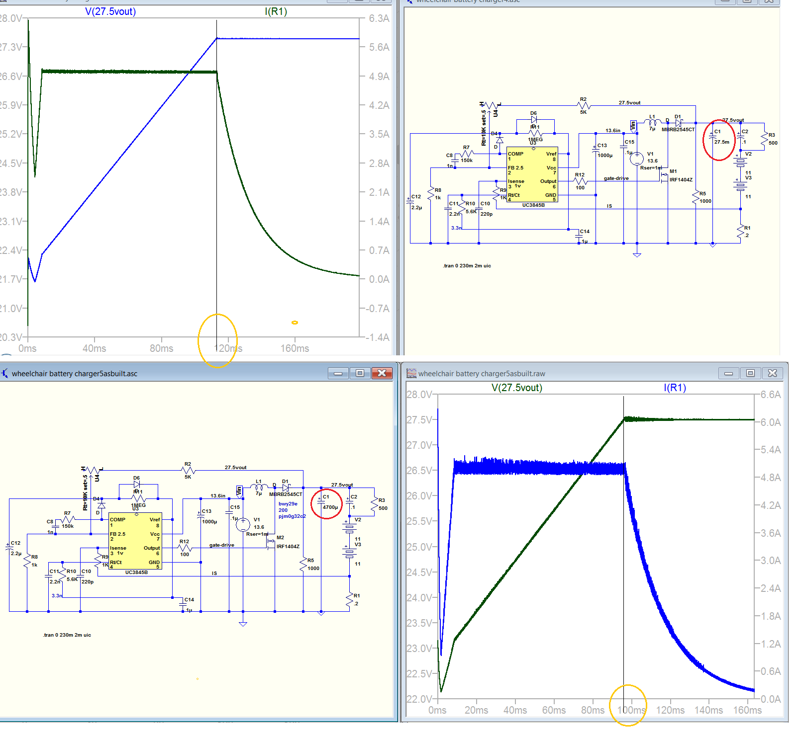

I've always thought that a battery acted electronically as a very large capacitior and to simulate the charging of a battery, I put a large capacitance in series with battery with a paralell resistor to prevent a simulated over charge which happened with out the resistor.
So, my question is why are the simulation lines so different if the battery acts like a huge capacitor, or am I wrong about that? I realize that SMPSs oscillate according to the size of the charge cap, so I guess the load capacitance doesn’t meld with the charge cap, any comments as to what's happening?
I also noticed that the battery and cap charged quicker with the smaller charge cap.

Spice doesn't have a discharged battery, so to simulate a discharged battery, I show each 12 volt battery at 11 volts and a series cap (C1) to accept the charge but I found out that if I don't add R3, it doesn't act like a battery
Jeff
I normally have the UC3845 watching the current in the MOSFET and inductor. That is how the part was designed. I think it will not be stable if it is watching the battery current.
Please attach your SPICE file.
originally, I did have the uc3845n watching the FET /inductor current, but it seems that watching the battery current works well as that is what's important and it is more exact. the inductor current is on and off and the duty cycle varies. Battery current is constant and limits voltage until voltage limits current at the end of charge.

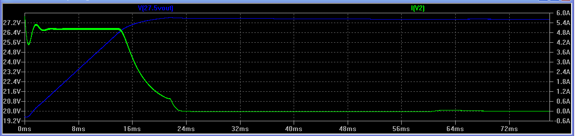

It looked clever in my computer game, as Nigel calls it, but in doing the electronics, I couldn't get the current I wanted, 5 amps is my starting goal. My computer game, Spice, shows a solid 5 amps charge, then it ramps down after the voltage hits it's set point, my electronics doesn't seem to work that way, damn, I hate it when you guys are right. Can you offer any suggestions?

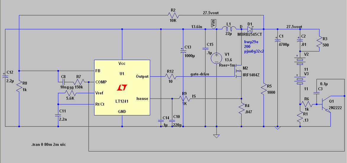

I don't have the "UC3845" so I used a LT1241 which is almost the same.
I used Q1 to watch battery current.
Regulates at 5A and 27.5V.
I changed C2 from 0.1F to 0.01F to speed up the simulation. (slow computer)

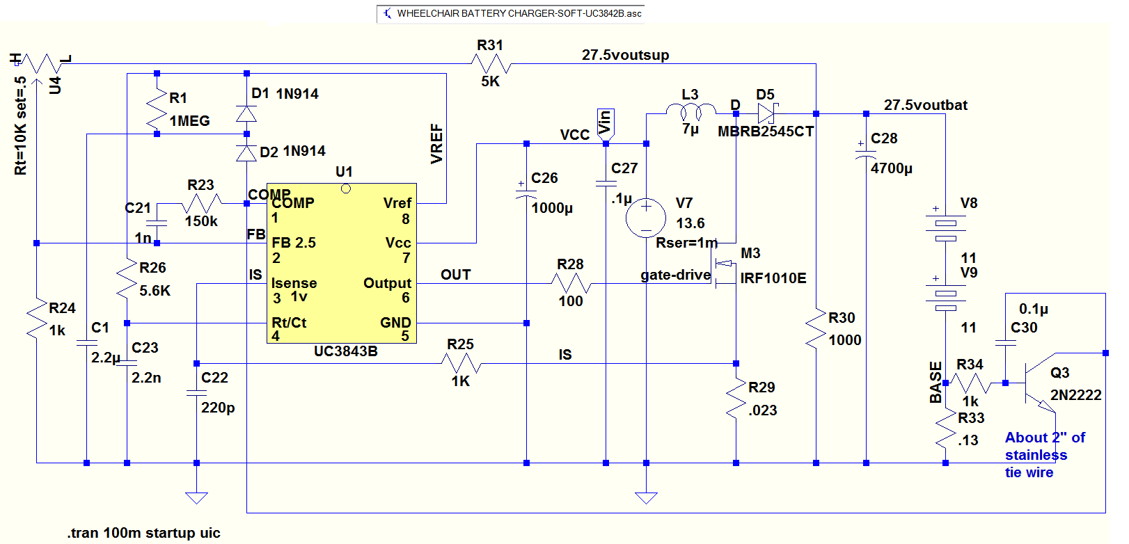

I have this running now and seems to work quite well, killed one UC3842BN, so I added the soft start, seems to work like I wanted, the higher the input voltage, the higher the amps in.
