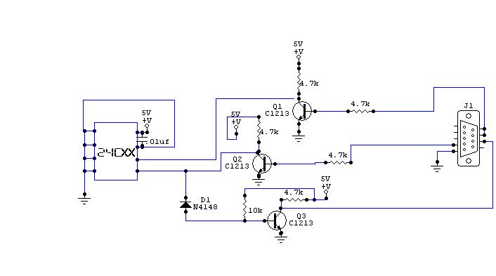

i have this circuit (attached file) and i make it and i am use pony prog or ic prog with invert data in, data out & clock but not verify my eeprom
plz check the circuit an and tell me its right or wrong plz urgent

As you named the post Copying instead of Programming,
I suggest that there are many stand alone copiers and you can use one or thing around improvising one without need for PC. Such copiers work off 3 dry cells You can save power
i am use only eeprom copy, i am working on inverter so many eeprom use in inverter mostly 24cXX so plz tell me how i copy eeprom throgh copmuter
i am succsefully read write eeprom with jdm programmer using by pony prog and ic prog
u also try this circuit,
if not run replace c1213 with c828
