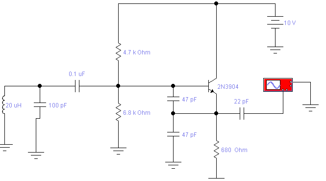

ok thanks for the information. I tried simulating the circuit below, which is a colpitts oscillator taken from a book. But the output i get is 0. May i know what have i done wrong? The program is Electronics Workbench 5.12

The ratio of the two 470pF caps should be larger than 1 to overcome circuit losses and still provide enough loop gain to oscillate. There should be a 0.01uF cap or so between base and +V to provide a low impedance path for feedback.

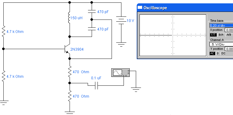

Here is a working circuit around 25MHz you may try. Transistor can be kept the same (2N3904) as any general purpose NPN will work

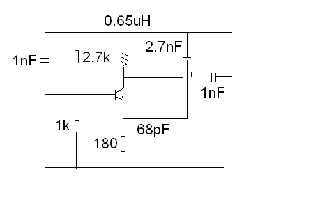

hmm i tried simulating another circuit but still there is no output. Is it the circuit or does the simulator having problems simulating oscillators?

It oscillates for me after making the top 47pF a 150 pF, but then also I use another simulation program. Frequency about 2.8MHz. Also I lowered the value of the emitter resistor to about 180 Ohm to achieve better I/P and O/P matching of the transistor. Remember some simulators have a problem with oscillator circuits if you don't set it up correctly. I am not familiar with the one you using.
:idea: You can try and make the top 47pF much bigger (1500pF) just to see if it is a loop gain problem and if there's any attempt to start up.

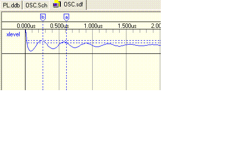

Below is a plot of the output frequency

Here is a typical example if there is not enough gain in the system. From the plot you can see there's an attempt to start up but not enough gain to sustain oscillations. In this example I made the top 47pF cap about 100pF

Try one more thing. Increase the emitter resistance to about 1.5k together with the top 47pF cap at 1500pF, if it still does not work it is most probably the program or the transitor model
