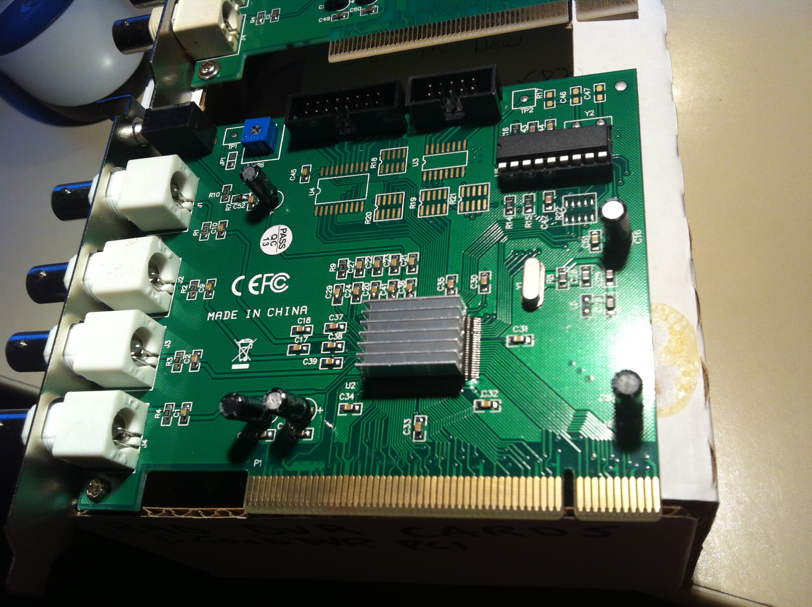

I have several defective DVR card that I removed from PC based security systems that I built due to the pci card unable to control a steady picture. I call the cards, "Jumpy," and replaced the card with a new DVR card.
Now the maker of the DVR card has stopped production of this amazing card, along with the software we have come to trust.
In an effort to try to save a few cards I replaced the 5 Caps on the cards just in case, but it did not solve the jumpy problem.
I'm now looking into the 28.63636 Crystal Resonator on the cards.
Could the Crystal Resonator be defective?
I'm good at replacing Caps if defective but new to the actions of a Crystal Resonator.
Every DVR card failed due to power fluctuations, power outages and the shock of power restorations and nearby lightning storms.

My main question is would a Crystal Resonator cause picture or video instability?
It's VERY unlikely a crystal would be damaged by lightning, much more likely are semiconductors - and in complex devices like these the prime suspects would be ones with smaller construction techniques, which are more easily damaged by large voltage spikes.

1. Are there any components on the bottom side of the board?
2. What does "jumpy" mean? Unwanted vertical movement? Horizontal? Random direction? Tearing or breakup in only part of the frame? Whole-frame movement? Video-related (bright flash makes things jump)?
Does the board mux four video inputs into one recording, switching among the 4 inputs in sequence? Or record a quad split showing all 4 inputs all the time? Or record 4 video streams?
Does the board have a monitor output that is switchable among the 4 inputs?
ak
The DVR card is very simple. As in the photo above, very few components. The board is one sided also.
I did change out a re-moveable chip that three of the bad cards have in common. the other cards have the same chip but it's soldered on, but it didn't correct the problem.
These cards were inexpensive DVR cards but it's the outdated software that is so easy to work. I have bought some other dvr cards but they do not work the old software.
The cards only have 4 bnc camera ports and act as separate video inputs.
I was hoping for a particular device on the cards that would affect the image. The problem is the 4 camera images when displayed thru the DVR card jump, very small distortions, but it's enough for the motion dection to start recording the movement.

It is true that a unstable clock will cause trouble.
It very likely the front end of the card is damaged. (where the video cable plugs in) If the board can not decide syncs the video will jump.
Thanks for the great help, I'll order a dozen of the 28.63636 crystal just to have on hand. I was hoping to rule that one out but I'll continue the testing.
You have a choice on the DVR card via the software, for all four video ports, or you can chose just 1 port on screen.
But all four video camera ports will jump a tiny bit, but that's enough motion to trigger the recording. And all 4 ports or video you see on the screen jump but not at the same time. It's a very random jump with the 4 ports and all 4 ports do not jump together or at the same time.
Even if I unplug any three cameras the single camera on screen will jump or shake just enough to start recordings.
On NTSC tv systems, a jumping screen is almost always caused by the sync separator circuitry misbehaving.
With a schematic, it is very straightforward to find the vertical and horizontal sync separators. And indeed, they use RC time constants to discriminate the vertical from the horizontal sync.
