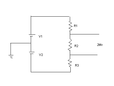

Hi guys,
What are the values of resistors do we need to use to gain the output of 2mV supply from 3 resistors and 2 9v batteries?
Thanks ...i really need your advise and how to calculate the resistor values?

I have roughly put the pics here.....How do we derive the calculations? 2-9v batteries and 3 resistors....

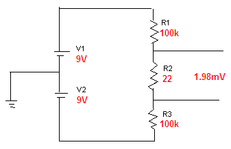

I didn't calculate anything.
I selected 100k resistors so the little batteries aren't loaded too much, then simple arithmatic selected the 3rd resistor.

2mV/18V= 1/9000. Select two resistors of 100k each for low current and their total is 200k.
200k/ 9000= 22.2 ohms.
Check: 18V/200,022 ohms= 90uA. 90uA x 22 ohms= 1.98mV.
Many resistor combinations will give an output close to 2mV.

Could the circuit below satisfy all requirements? I leave the values up to you.
AllVol

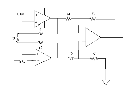

its output is meant to be connected to a 3 op amp cct.... iwill upload the cct later.
Thanks to you guys its known that r1=r3.How do i derive the calculations with just the known values like vout=2mV, Vsupply=18V.I need to show how i got these values...

Okay guys ...now i have some more information.....both the outputs need to supply 2 mV each....i guess thats why 3 resistors are used.Now the calculations part.....
AllVol
The resistor R3 in your circuit doesn't do anything and isn't needed.
Carnby,
After 30 replies now you show that you have an instrumentation differential amplifier made with 3 opamps. Why not lookup Differential Amplifier and Instrumentation Amplifier in Google to learn all about them?
