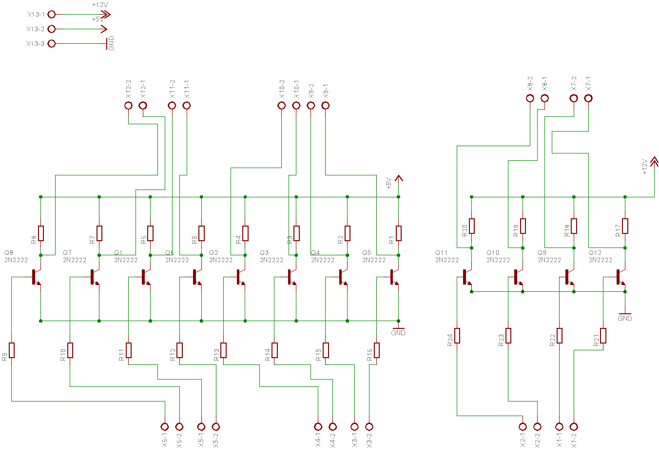

please check this schematic may be i have something wrong , i'm going to make it's PCB,
the function of this board is to get a signal from PIC16f877 main board and run H-Bridges and other circuits which required 5V or 12 Volt but with more tolerance with the current
i'm using 2n2222
thank you

Looks fine, most use a ULN2803 to do the same thing as it has the diode clamps and higher gain than the 2N2222A plus a nice simple DIP package.
Your circuit doesn't have resistor values nor does it have a load. So it might work, it might not work or it might blow up.
If it is designed properly:
When an input is high then the output of a transistor is low.
When an input is low then the output of a transistor is high.

Better to use a SN754410 Quad Half Bridge. 1.2A with thermal shutdown, nice part. Of course larger ICs exist and will save you burning out transistors. Your original 2N2222 circuit is not an H-Bridge, you'll need PNP transistors too for a proper H-Bridge.
Unlike good Mosfets, darlington transistors have a voltage loss. An H-bridge made with darlingtons could have a loss of up to 6V.
A "1A" motor draws 10A or more when it starts and when it is stalled.

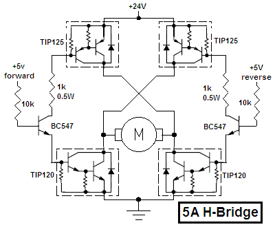

Try this H-bridge that uses darlingtons:
Yes my original circuit 2n2222 is not an H-bridge , it's just a connection between the PIC main control circuit and the H-bridge ,
my H-bridge is working very well and up to 1.5A,
but i'll try the new one as it's for 5A , may be i need that capacity later

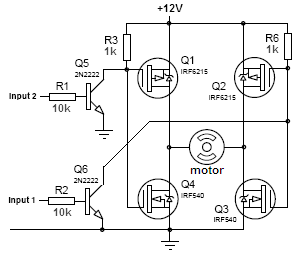

I would recommend the IRL540 MOSFET.
This circuit uses N-channel and P-channel Mosfets.
