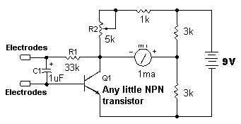

Are you making the Simple Lie Detector project? It works with any little NPN transistor: 2N2222, 2N3904 or BC547 pops into my mind.
Make it with a 9V battery:

3k is a standard 5% resistor value. Two 1.5k resistors in series makes 3k. A 1.2k and a 1.8k in series makes 3k, and many other series and parallel combinations.
But that simple circuit will also work with 3.3k resistors.

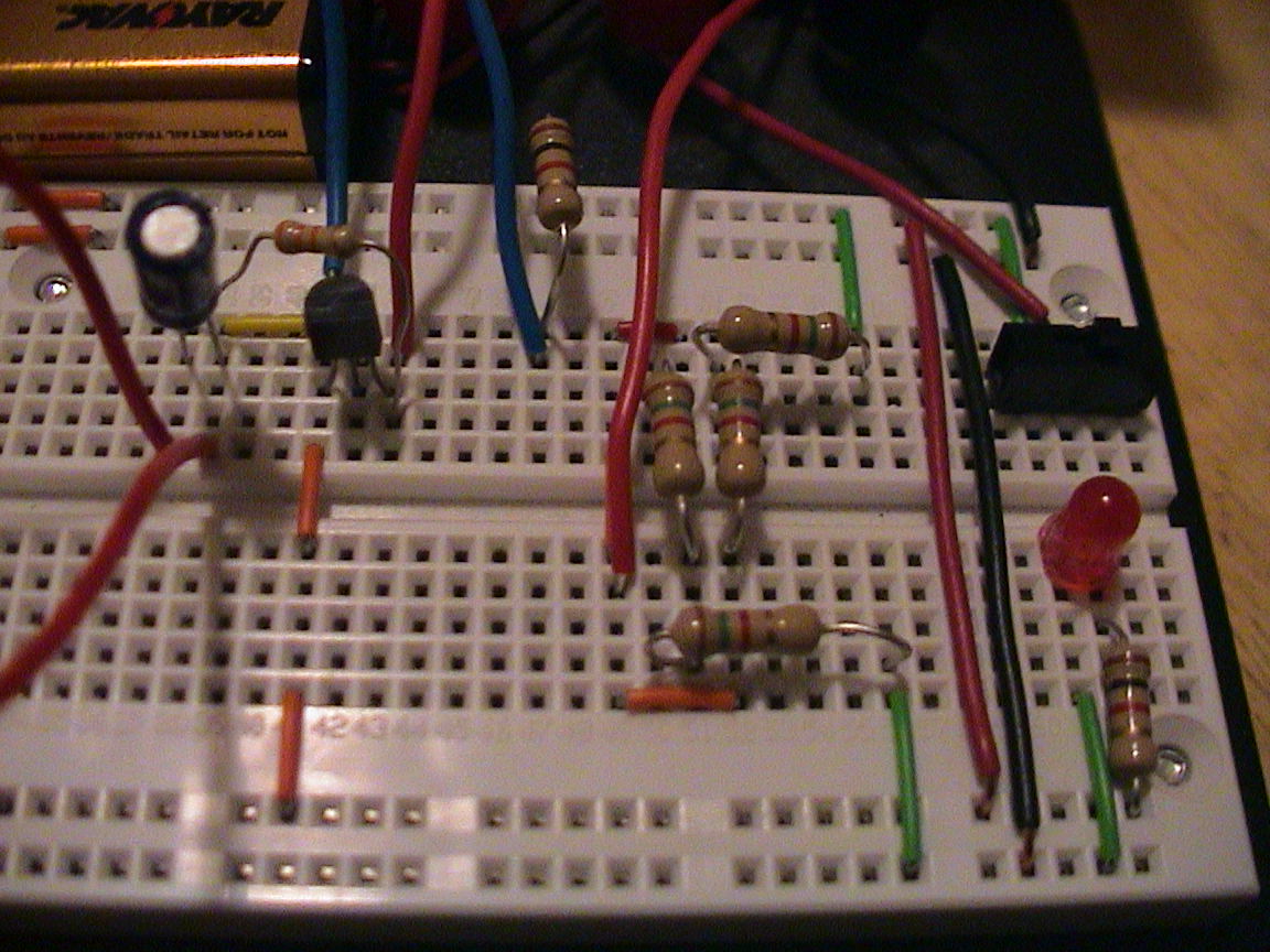

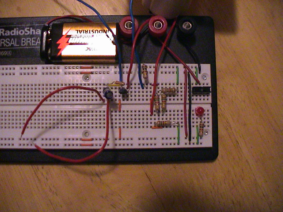

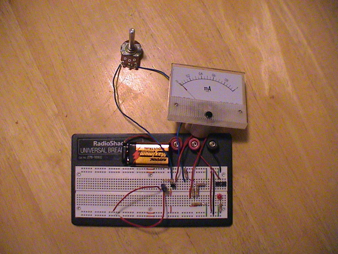

I know this is the wrong place to post but I have built the lie detector circut and the needle on the meter goes the wrong way( past zero). Do I have somthing backwards?
I think it is normal for that stupid simple circuit to show the meter needle pointing backwards when the probes aren't connected to anything so the transistor is turned off. With skin between the probes the meter should show near zero and you can adjust the pot for zero. Short the probes or have sweating skin and the needle will move forward.
I hear an echo. Are you Robdude on Aaron's forum?
You fried your transistor by using it to short your batteries before.
During your reply here, click on Manage Attachments. Then click on Browse and double click on your pic or schematic. Then click on Upload. Then Submit Reply.
I can't see where the battery wires are connected and can't see which connects to what.
Look at the datasheet for the 2N3904 to see its pins.
