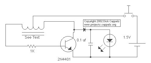

Please post a schematic so we know what you want the transistor for.
here the dia
see the dia
That isn't critical, any small pnp transistor will do, try the BC560.

That circuit is so simple and uses such low voltage and low current that it will work with any little NPN transistor.

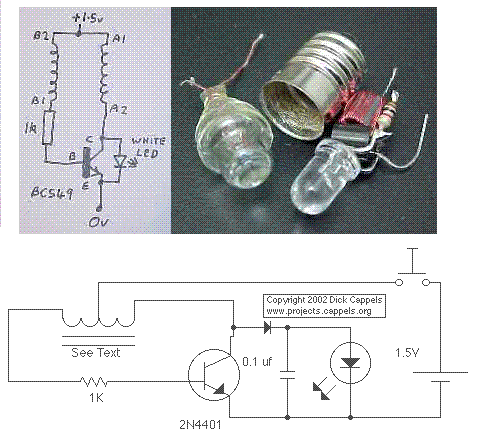

Our other topic has nearly the same circuit:
Almost any NPN transistor should work
just fine in this circuit.
You might be able to find a Motorola
2N4275.
Also a Motorola type MPSA06 is a hefty
little--fairly high IC transistor.
Hfe approx 40
Hope this helps....Art

The core for the voltage stepup circuit I posted is an ordinary ferrite bead that is used for a small inductive choke.
There is another topic on this site in the last couple of days describing it called Joule Thief so search for it here or in Google.
Sorry I didn't know where I got the PNP transistor idea from, if course that circuit uses an NPN transistor.
