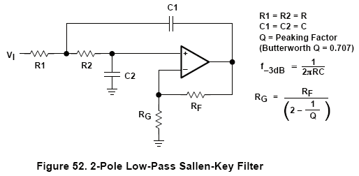

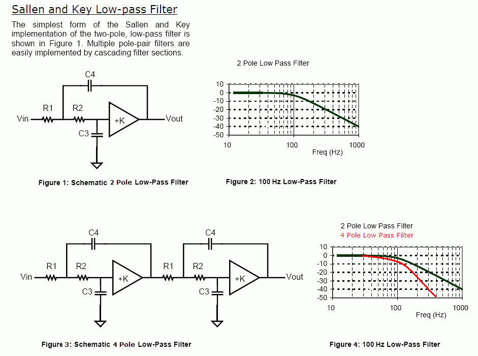

You have a horrible droopy filter.
Why not make a Sallen and Key Butterworth active lowpass filter? It is -3db at the cutoff frequency and has a sharp attenuation of higher frequencies.

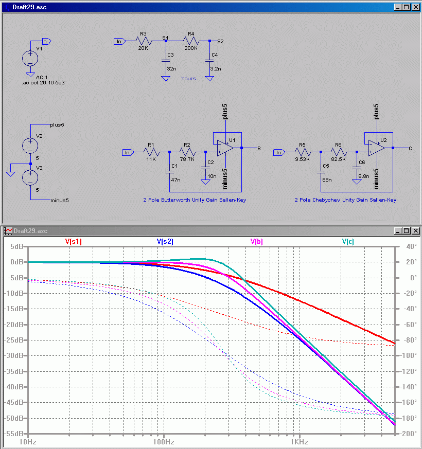

Look at the red and blue traces. Note that your two poles stack up and cause the attenuation at 250 Hz to be -6db while per normal practice, the cutoff frequency is defined as being down 3db at the cutoff freq.

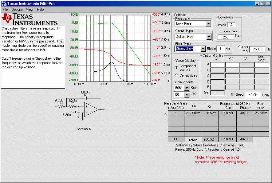

I compare yours to a 2pole Butterworth (purple trace) and a 2pole Chebychev (lt. blue trace) as computed by FilterPro, a free download from TI's website.

If your filter is designed for 100Hz then its response at 100Hz is down -6dB. A Butterworth 2nd-order filter is down -3dB.
Your 100Hz filter attenuates frequencies as low as 20Hz but mine is flat to about 60Hz or 70Hz.
Mine has the correct slope at about 130Hz but yours still doesn't have the correct slope below 300Hz or 400Hz.
