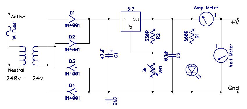

I've created a second power supply (the schematic attached) using a variable voltage regulator.
All works well in theory. I have a volt meter as part of the circuit, and it's reading goes up and down as I turn the pot. I also have an ammeter connected.
However, there is a really fundamental problem that I have overlooked somewhere. When I attach a small DC motor to the output, the voltage drops to zero, and the current goes up a little.
There must be some really simple principle or law I'm overlooking, but I'm not that experienced, so I can't see what it is.
PS, I didn't have this problem with a fixed voltage, using a 7809 regulator that I posted in a previous thread.
Thanks anyone who can enlighten me on this...

For a start R2 is much too high, it should be 120R otherwise it won't regulate properly under light loads. The LED will help you at higher output voltages but it won't draw the minimum load current at lower voltage settings.
R1 might also be too low for the LED, it'll allow about 33mA to flow which will probably exceed the maximum rating of the LED.
C1 is far too small, for 1.5A it should be at least 1500µF though I'd recommend 2200µF.
What's the current rating of the motor?
It could be overloading the regulator.
Are you using a suitable heatsink?

The smoothing capacitors on the input and output of the regulator or NOT adequate.. 1000uF and about 470uF are required.

The datasheet says that R2 can be 240R. I thought this could be changed (to change the ratio of R1 and VR1). I'll change it back to 240R

I did find that if I turned the voltage up, R2 would burn out. It's power rating must be too low.
If P=IV, and the circuit can provide up to 1A at a max of 27V, does that mean the resistor must be 27W? That sounds really huge... Have I got that wrong?
Correct. But not for an LM317. 240 ohms can be used for the more expensive LM117.
If your circuit is connected correctly then the current in the pot is only 5mA which will not burn it.
You are talking about the load. It has up to 27V at up to 1A which is 27W.
The pot will have a max voltage of 25.75V at 5mA which is a power of only 0.129W. Isn't it a 1/2W pot? The pot will dissipate more than 1/2W if you use the correct value for R1 for an LM317.

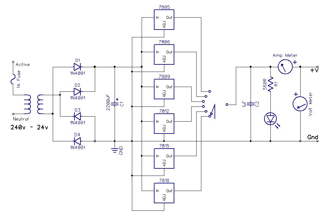

Using the LM317 I found that it was hard to get an accurate output.
Would it be good to use multiple LMxx rectifiers with a switch?
Or one 'large' rectifier like the LM7818 and have voltage dividers running off it? Would the voltage dividers cause the voltage to be inaccurate too?
I have included a conceptual schematic of the multiple rectifier design...

What would be the point of this design, only one Vreg would be selected at anyone time.?
Voltage dividers will not give a stable voltage under different load conditions.

Yes, you're right, Multiple regulator design.
I only want to have one voltage output at a time, but I want it to be selectable. So I can turn it to 9v for one project, 5v for another, etc...

That's why I was thinking of using multiple regulators.
Yes, heat will be a big problem. I will of course need to have big heatsinks on each regulator. Perhaps I could use a multitap transformer so the 'smaller' regulators won't have to deal with as much voltage?
The other reason that I don't want to go with the LM317 is because it would be more open to user error. I could accidentally turn it to 10v instead of 9v by mistake, whereas a rotary switch would 'click' into place.

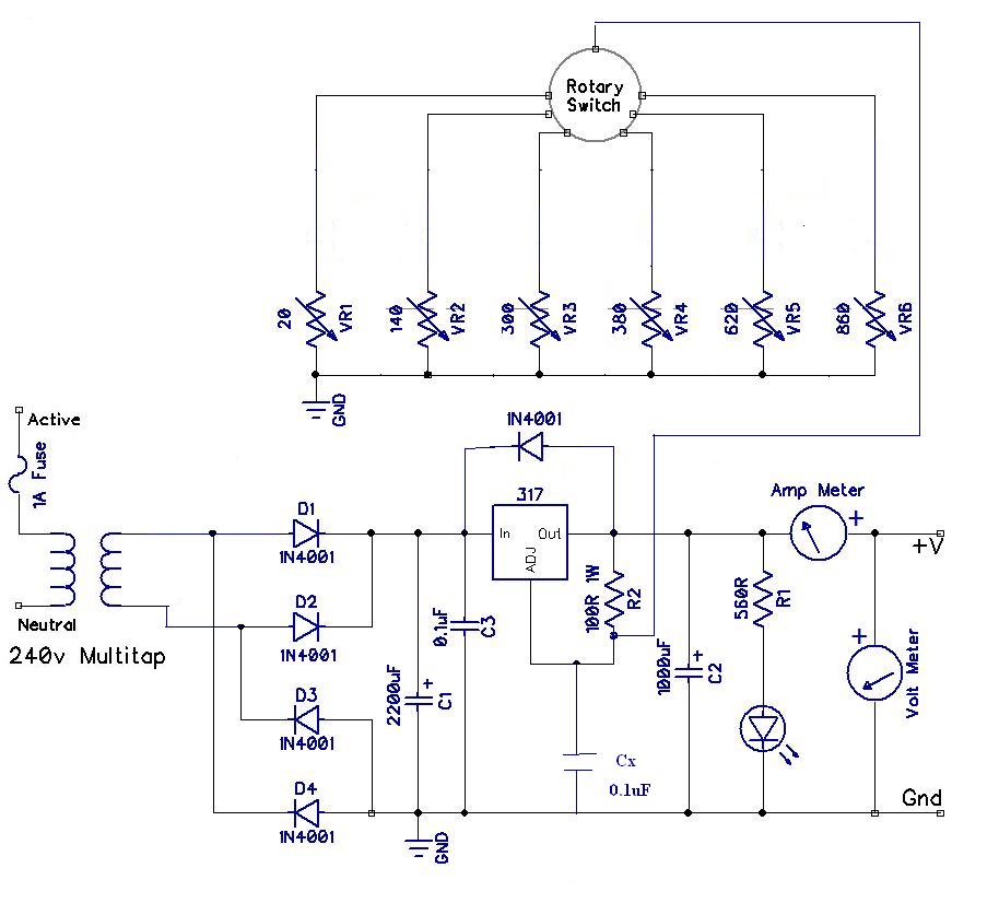

I have included a new conceptual idea for a power supply. Unfortunately it is a little crude, so I will explain it here.
The idea of this one is to have the LM317 with trimpots to adjust the voltage.
A rotary switch is used to select the voltage.
There is a transistor (used as a switch) with the base connected to the rotary switch. The emitter goes to the bridge rectifier, but the collector goes to a multitap transformer.
Although not shown very well on the schematic, the collector of each transistor has a different voltage from the transformer. The reason for this is so there is less voltage going into the voltage regulator when it has a low output.
The less voltage in should mean that it does not have to dissipate as much heat, and the risk of burning out is much lower. It will still have a heatsink.
I haven't worked out the details on the transistors yet.
Will this work?

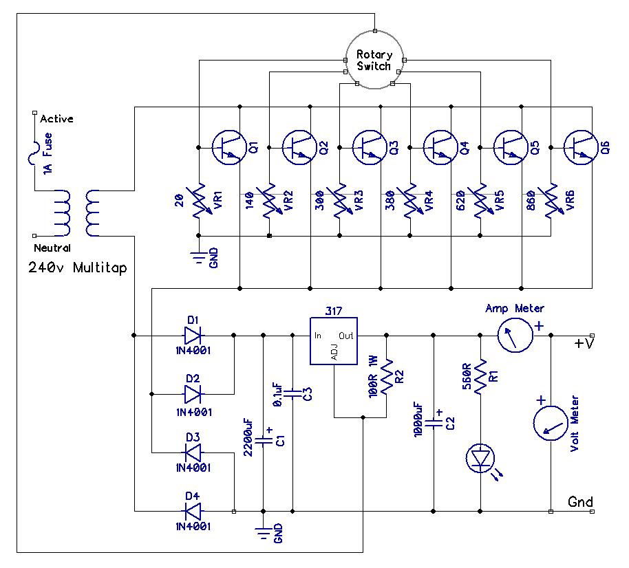

It is wrong as you never got the DC bridge through properly and these switching transistors are shown connected at AC level. It should be like the attached modified schematic.

OK, I'll add the capacitor on the ADJ terminal, and the diode across OUT and IN terminals.
If the transistors are no good, is there any way I can make the input voltage selectable? I don't want to burn out the voltage regulator if I'm putting 18v or more into it, but only getting 1.5v out...
