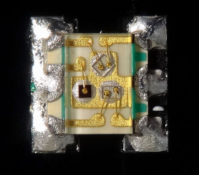

You are confusing the actual packaged transistor with the chip inside the transistor package. It is easy to connect the bond wire from G S or D region to any pin on the transistor package.
Here a few pictures of the 2Sk146, it is just two transistors in aluminum housing, in one picture that cover has been removed.
