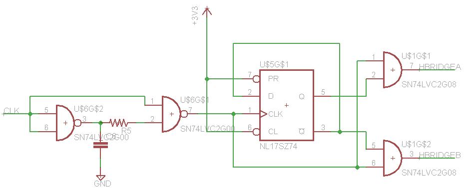

Hi - first time posting to the forum, so please be gentle. :D
I'm trying to build a very compact circuit to drive a 10 nH coil via an H-bridge at 3 MHz. A very similar application requires the same thing at 10 MHz. Each circuit (including fets and a tiny PIC) has to fit into a 40x20 mm area (not counting the coil).
My first thought was to start with a 20-40 MHz oscillator, put it through a counter and then use some gates with an RC circuit to put in a deadzone where all the FETs would be off (to avoid large cross-over currents). However, this has turned out to be too bulky.
I think what I really need is a motor-drive IC, but I've not seen any that can handle anywhere close to 3 MHz, let alone 10 MHz.
Does anyone know of a suitable part, or have any suggestions? I'm just about ready to consider putting in a signal micro to drive the bloody FETs directly. Any thoughts?
Edit: I only need 3.3 v across the coil, so the FETs don't have to be fancy. There are no huge currents involved.
-Kell

I have a circuit which I've tested on the bench that sort of produced what I need, but with some problems. I keep getting some glitches on the output (see attached). I've got big capacitors on the supplies to all my chips, but I suspect there is something I'm missing - maybe a race condition?
Any thoughts?

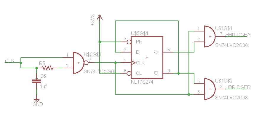

Before we go farther, what the hell is that 1uF cap to ground doing on the clock input?

ccurtis - Good points and something I had not considered. The glitches are on the outputs that drive the fets - if they glitch at the wrong time, current will flow direct from power to ground, wasting precious battery power. Sinusoidal power is a possibility... I put a filter on the fet inputs and use them like an amplifier rather than a switch. It will require adding four components, but it might just work a treat.
Roff - another excellent point, and a consequence of making last minute changes to circuit diagrams that then don't reflect what you're actually doing. In the real circuit there is a gate between the clock and the filter - in my haste to produce a jpg to post I forgot to include it. Mea culpa.
I've attached the corrected circuit, now fortified with extra correctness.

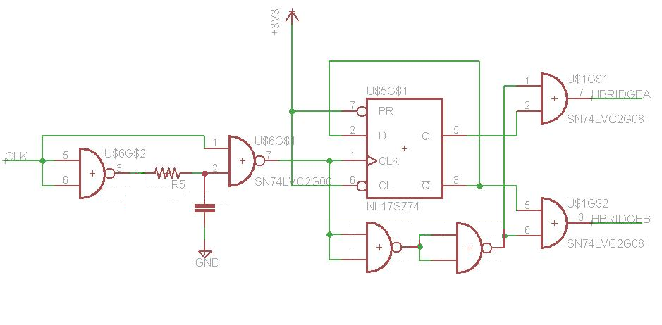

Loading the output of a gate with a cap to achieve timing requirements is bad engineering. Perhaps you meant to put it on the other side of the resistor?
Even if your drive to the H-bridge has a dead band, there are limitations within the H-bridge on switching speed, such as gate capacitance that prevent one half of the H-bridge from being able to turn-off before the delayed turn-on of the other half.
Yes, and if the cap is placed after the resistor to create a delay, putting the delay at the clock input isn't going to create a dead band. It would be placed after one of the outputs.
The delay creates a short negative pulse at the clock input. When you AND that with the two flip-flop outputs, you do get a dead zone, but there needs to be a couple of inverters added between the clock input and the inputs to the AND gates, or he will get glitches due to the propagation delay of the flip-flop.
Yes, I see that now. Only one of the gates will switch with the clock, depending on the state of the flop. The flip-flop switches after the output gates are clocked, causing a glitch.
