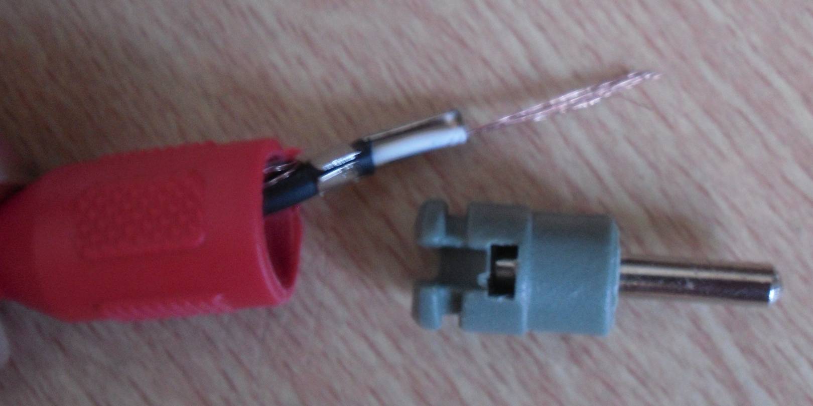

Ive got a 3.5 stereo jack to RCA cable to connect my laptop audio to my LG 42LH300. i've tried it already and it works however the wire became detached from the center pin connection and im not sure as to how i can connect it toghether again.

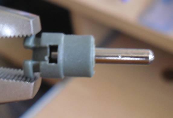

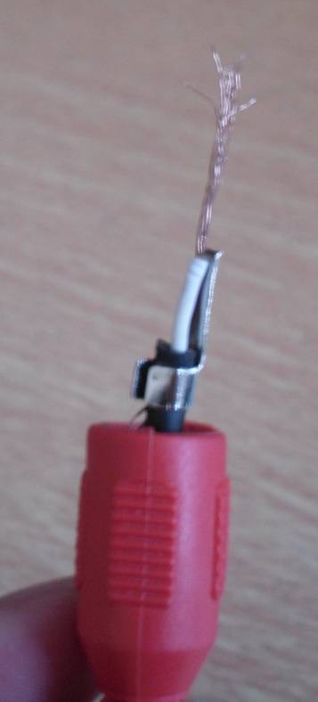

I've attached a picture of the centre pole and its casing, also the wire (stripped) which was leading into the gap in the centre pole.
Any help on how to connect them back toghether working would be much appreciated.

It's far easier to simply buy a new male RCA phono plug and solder it on the cable.
If you want to try soldering it do this. You will need rosin flux, small diameter solder (small enough to go through the end hole of the RCA pin), and a low power soldering pencil.
Apply a small amount of rosin flux to the wire and stick the wire into the RCA pin.
Don't pull on the wire when you unplug the connector.
Place small length of the solder into the hole of the RCA pin.
Apply the hot soldering pencil tip to the side of the pin. When the solder melts feed a small amount more of the solder into the hole.
Remove the soldering iron and hold the assembly steady while the solder hardens.
