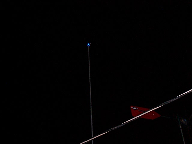

I just went ahead and added 470 ohm resisters to each. for the meanwhile.
They look very bright. will leave them hooked up overnight and see how they do.
This way I'll only need two wires to run up the anemometer pole

You did ask for the 'best' way not the easiest =) If your have free air cooling your resistors will likely work forever if they're rated properly. Just keep mind mind how much power you're throwing away. If you're okay with that, the the circuit is fine the way it is.
It isn't even the easiest or cheapest.
If you ask me connecting the LEDs in series is just as easier and less resistors is cheaper.
The one thing I can say for using a single LED with a bigger resistor is that the larger resistor dropping more voltage will act more like a constant current source than the three LED's in series with the smaller resistor, it will dim/brighten more with voltage changes. That's why I recommended a constant current driver instead of a resistor as you get perfect lightning regardless of the voltage then.
