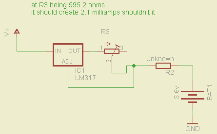

would this work to charge the battery decribed in the first post:
charger-png.36428
i have made it very simple but i was wondering what value R2 should be. Should it even be there. also what voltage should my source be. i don't know if it a safe charger (or if it even would work(not blowing up the battery)) so if it is not please tell me how to make it safer (i know there is no way to automaticly turn off the charger but that will be added later)
The 3.6V battery will be at about 4.2V when fully charged. The LM317 needs a minimum of 2V plus 1.25V for the current sensing resistor. The total is 7.45V minimum.
R2 does nothing and is not needed.

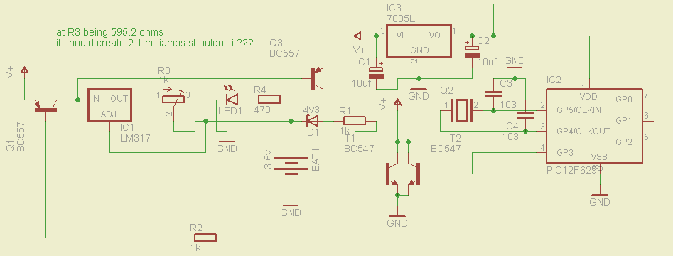

I have slightly changed the schematic for thge charger so would you tell me if this would work:
charger-png.36456
Notes/Questions
:)Is the zener diode ok.
:)i relise i am missing a transistor on the base of Q3 but please pretend there is one.
:)V+ = 9 volts.
:) do i need a resistor going from ADJ of the lm317 going to ground.
:)The PIC has delay routines which count 14 hours before turning on he pin stoping the currrent from flowing.
:)Does Q1 need to be more powerful than a BC557
:)C1 = 100uf
The differential transistor will be turned on most of the time because a 4.3V zener diode conducts a little when it has only 3.0V across it. Then the base-emitter voltage will be 0.6V so the differential transistor turns on when the battery voltage is 3.6V.
You need an accurate comparator circuit, not a poor low voltage zener diode.
The datasheet for the LM317 shows the current-regulator circuit.
The datasheet for the BC557 shows its max allowed collector current.
