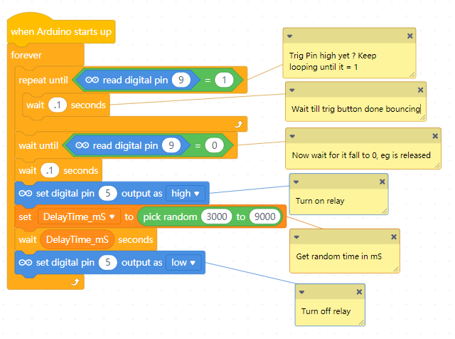

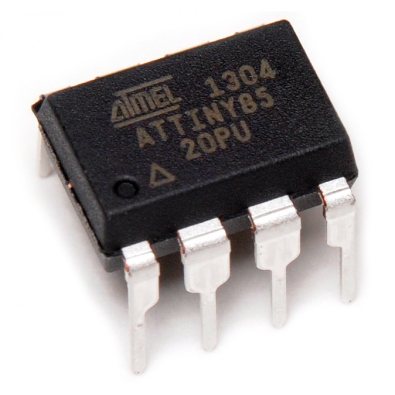

Quick and dirty with Arduino or an ATTINY85 using mBlock graphical programming.
Drag and drop function blocks into 3'rd window, configure, then program part.

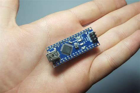

mBlock generates Arduino code from the block configuration. Use a Nano board,
~$3, or a Nano board as programmer for an ATTINY85.
Regards, Dana.

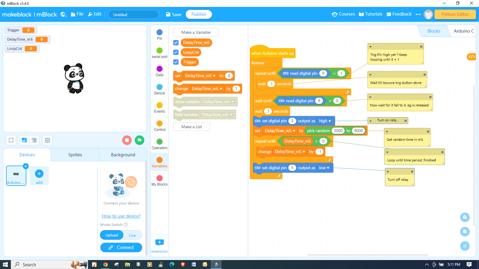

I managed to screw up the block coding, it should be as follows :
Regards, Dana.
