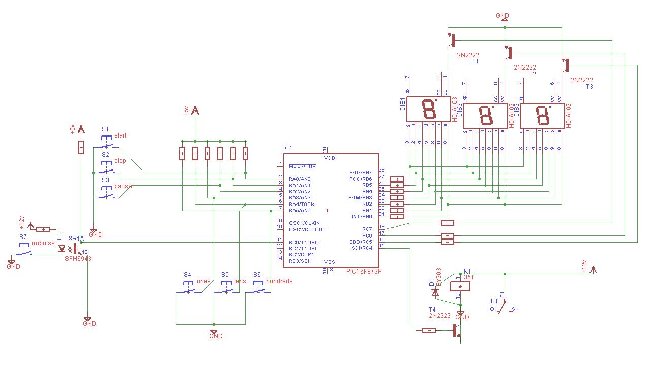

Hello everyone, I made a counter with 3 sectional of the schematic in attachments.On schematic is another pic, and I use the 16f76, 4MHz oscilator.Display with common cathode.
In the Basic, I got the written code and tried to adjust it to end,but i do not now how and i ask for help!
The counter is conceived to work like this: When the timer turns on dislpleju keys (ones, tens, hundreds) to set the desired number (say 100). When you've set that,when the "start" button pressed -activates the relay (portc.4) and display shows three zeros and controler "waiting" impulses with pulse from portc.0.Each impulse from portc.0,display is shows as number.(frist is 001, the second impulse on the display-002...) and so on until impulses reach to set number (in this case 100). Then relay is off,and count is stop.
"Stop" button is used to stop program- in a any time.When" pause" is pressed, the counting impuse stops, the relay is turned off until the start button is pressed again, when the counting continues counting from '"place"(number) wher a "pause" is pressed,and relay is on again.
I got seting up number code, how to do a rest of code?
Ufffffffff complicated right? :) Driving me insane,please help...
p.s. Sorry on my bad english!
