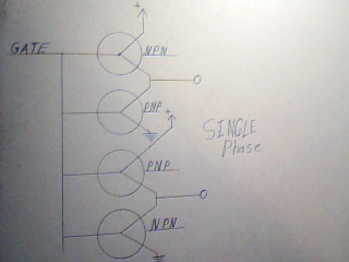

the below picture is what i have drawn up, i would assume i need 3 of these circuits all gated by seperate square waves? each gate has its on time to come on and go off.
again, i am not really sure how 3 phase works under the microscope, so this leaves me unsure of how to apply the 3 gated signals.
in the end, "one" potentiometer will control the frequency of all 3 gate signals. this way i can change the frequency to gain the harmonics i am wanting.

WHat you drew is a single phase, 4-switch rectifier (it is also an H-bridge used to drive brushed DC motors to allow reversing direction). (And you should have separate signals for the gates. Ideally you can drive a singlke P/N pair with the same gate signal, but in practicality bad things happen when you do this because devices are different and are not perfect).
THis is a 3 phase inverter/
https://en.wikipedia.org/wiki/Image:3-phase_inverter_cjc.png
You apply the PWM signal to drive a SINGLE phase in the method I Described above about turning on the high side transistor on whenever the triangle wave is higher than the sine wave, and to turn on the low side transistor whenever the triangle wave is below the sine wave. (THe sine wave and triangle wave being waves stored in memory and compared to each other) to produce a proper PWM signal whose fundamental is that of the sine wave stored in memory. To produce the other two phases, you just shift them by +120 and -120 degrees from the first.
I would also use MOSFETs rather than BJTs or IBGTs- much less losses at these power levels and easier to switch (and switch faster). THe MOSFET behaves as a very small resistor while the BJT behaves as a diode. At these low power levels, the current forms less of a voltage drop across the MOSFET's resistor than the BJT/IGBT's diode so you have less power loss which means less cooling and smaller devices. Only at higher current levels does the diode voltage drop become less than the voltage drop formed across the resistor by the current.

??? I am saying that in a P/N FET pair, they both behave in predictable ways relative to one another. WHen one does one thing, the other one always does the opposite (ie. when one is one, the other must be off. you don't want both on at the same time or it makes a short circuit). THis means you ideally can control them with a single signal (you might need an inverter along the way or use a P-type and N-type device so they behave oppositely to the same gate drive signal.
But, in real life FETs aren't identical and turn off slower than they turn on. THis means that if you apply a signal for one to turn off and other to turn on at the same time, there will be a time period when they are both on = short circuit. YOu either need circuitry to deal with this, or use a programmable chip (a microcontroller) that basically controls the gates independently and adds in a delay between switchings to make sure both are never on at the same time.
BTW, when I talk I speak of just one phase. Since controlling all the other phases is pretty much the same thing, you just delay everything in the other phases by 120 degrees.

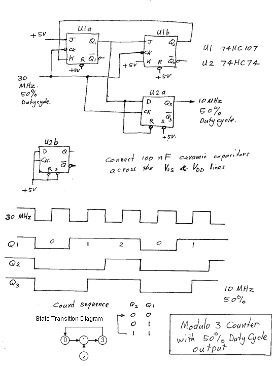

The simplest way to generate these waveforms would be to use a Modulo 3 counter with gating to provide the outputs.
I designed the circuit in that attachment for someone in this forum some year or 2 ago. It is intended for a different purpose, but can be easily adapted to your purpose.
U1 is configured as a Mod 3 counter. You don't need U2.
The Phase 1 signal can be taken from the Q1 bar output of U1a and you can use 2 NOR gates to generate the other 2 signals.
You need to drive the counter from an oscillator whose frequency is 3 times the frequency that you want at the output.

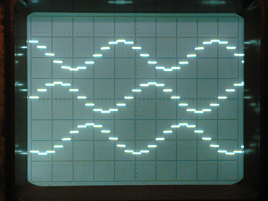

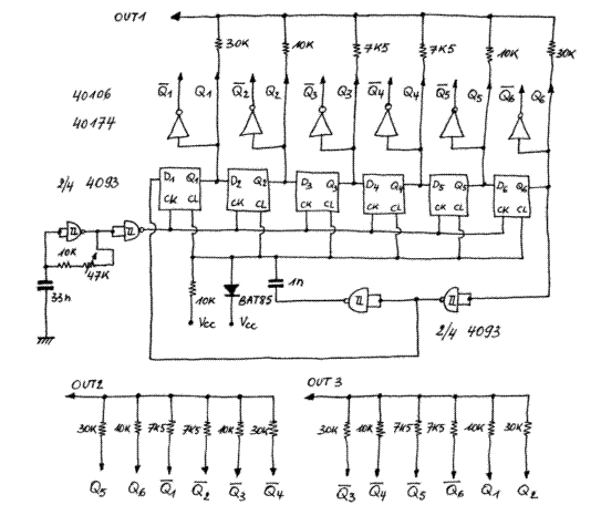

Something cheap and simple, what about this ?
No idea how it works though. :D

Ignore my previous post. I forgot that the Mod 3 counter will give a duty cycle of 33/67%, not 50/50%.
Making it 50/50 would require some gates.

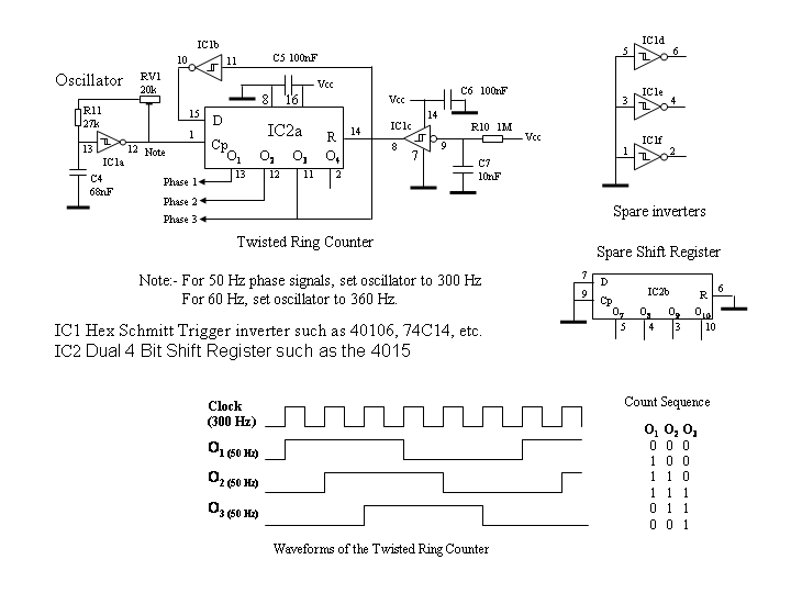

The attachment is an extract from a 3 phase meter that I designed and built for a friend some years ago. It generastes 3 pahes signal with a 50/50% duty cycle. IC1c is the "power on reset" which is necessary with tristed ring counters to prevent the possibility of it starting in one of the "trap" states.
Note that Q2 needs to be inverted in order to provide 120 degrees between each phase signal. Use one of the spare inverters.

oh my is it that simple? that little thing lol, this is awsome..
i see to where you can set it to get 50 or 60 hertz so how do i make that more of a wider range? could i just use a 100k pot?
i assume that on some higher frequencys the caps would have to be changed?
Oh, i think i see now! you just change the clocking to get whatever hertz you want?
oh yeah!!!! very nice and simple circuit!!! i was about to flash a chip..
EDIT, i see that the clocking for 50 to 60 hertz is 300MHZ.
i was wondering about slowing it down so you can get 60 hertz at say 20 MHZ, this way when i add a variable Clocking source i can easily scan threw the hertz for harmonics by changing the clock source.

EDIT, i see that the clocking for 50 to 60 hertz is 300MHZ. No! it is 300 Hz.
The counter is a Modulo 6, so it divides the oscillator frequency by 6!
From memory, a square wave signal has odd harmonics, for example, a 100 Hz signal has harmonics at 300Hz, 500 Hz, 700 Hz, 900 Hz, etc.
