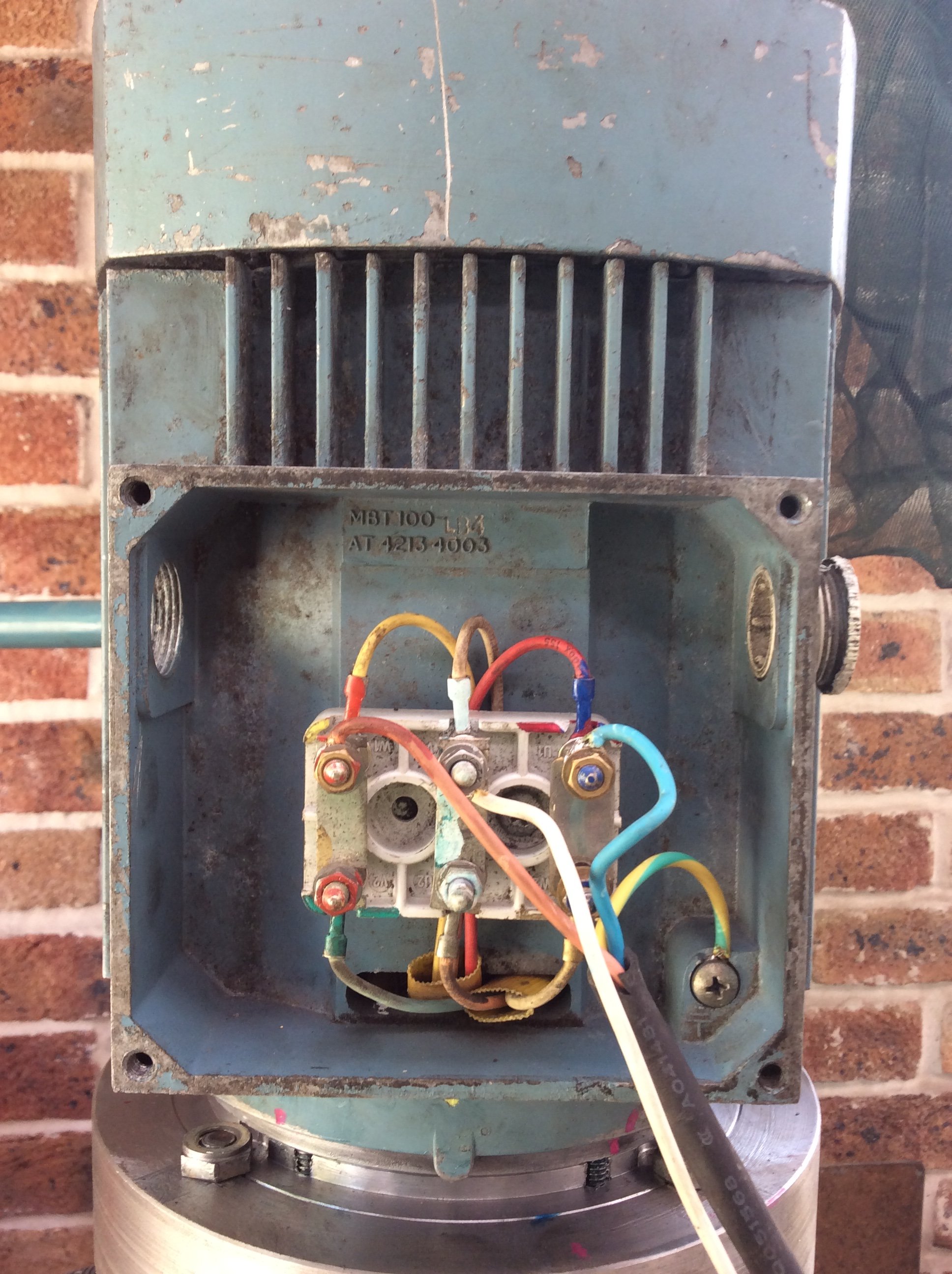

I have a 3 phase motor with no plate or manufacturer name .
The motor is delta .
How can I tell the HP rating and speed of this motor.
I do not have 3 phase power supply.

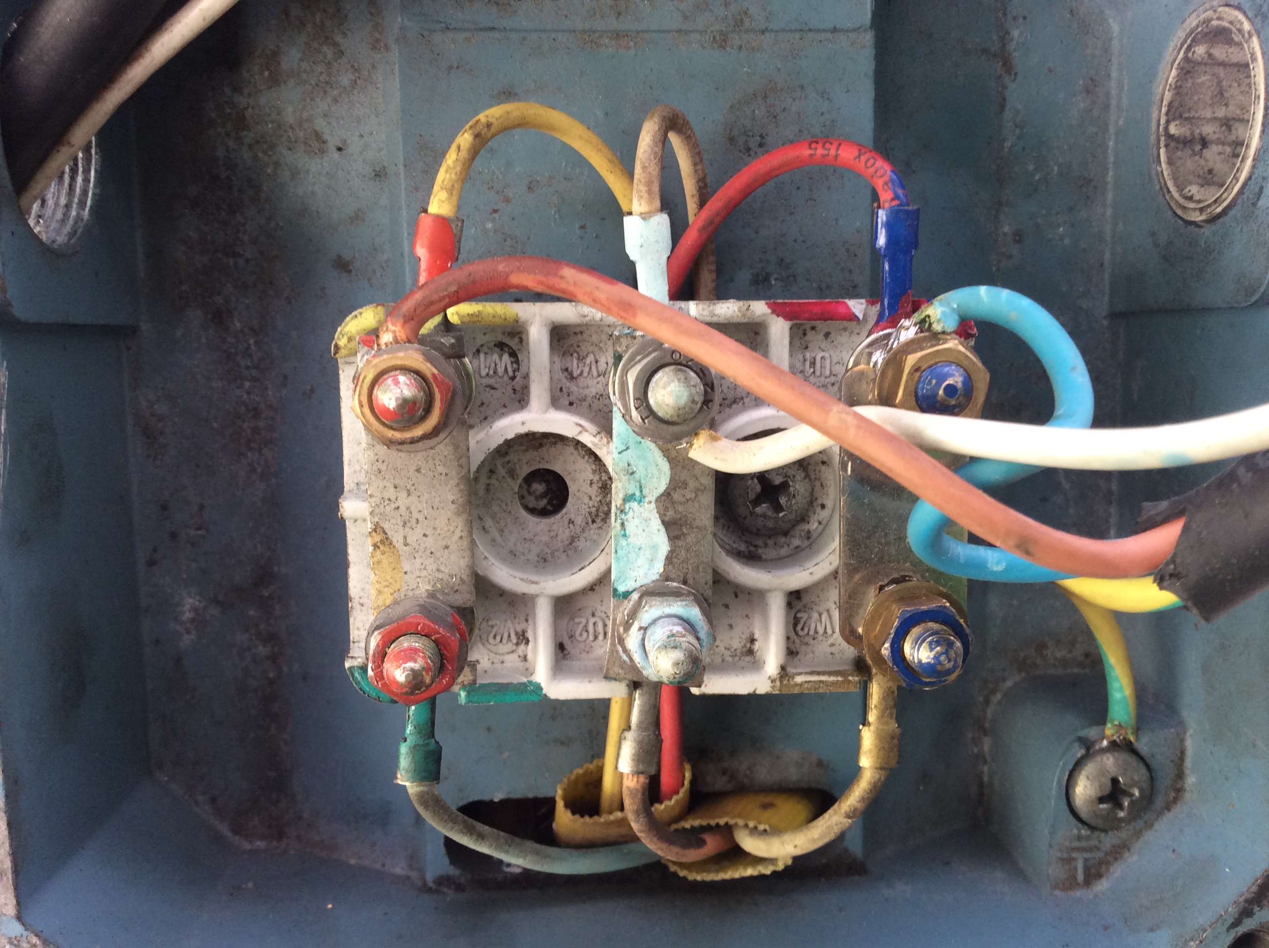

I have 6 wires which are connected with a bridge . In delta
I do not understand but are you saying that this motor can run on 240 v Ac
Could you give me more information

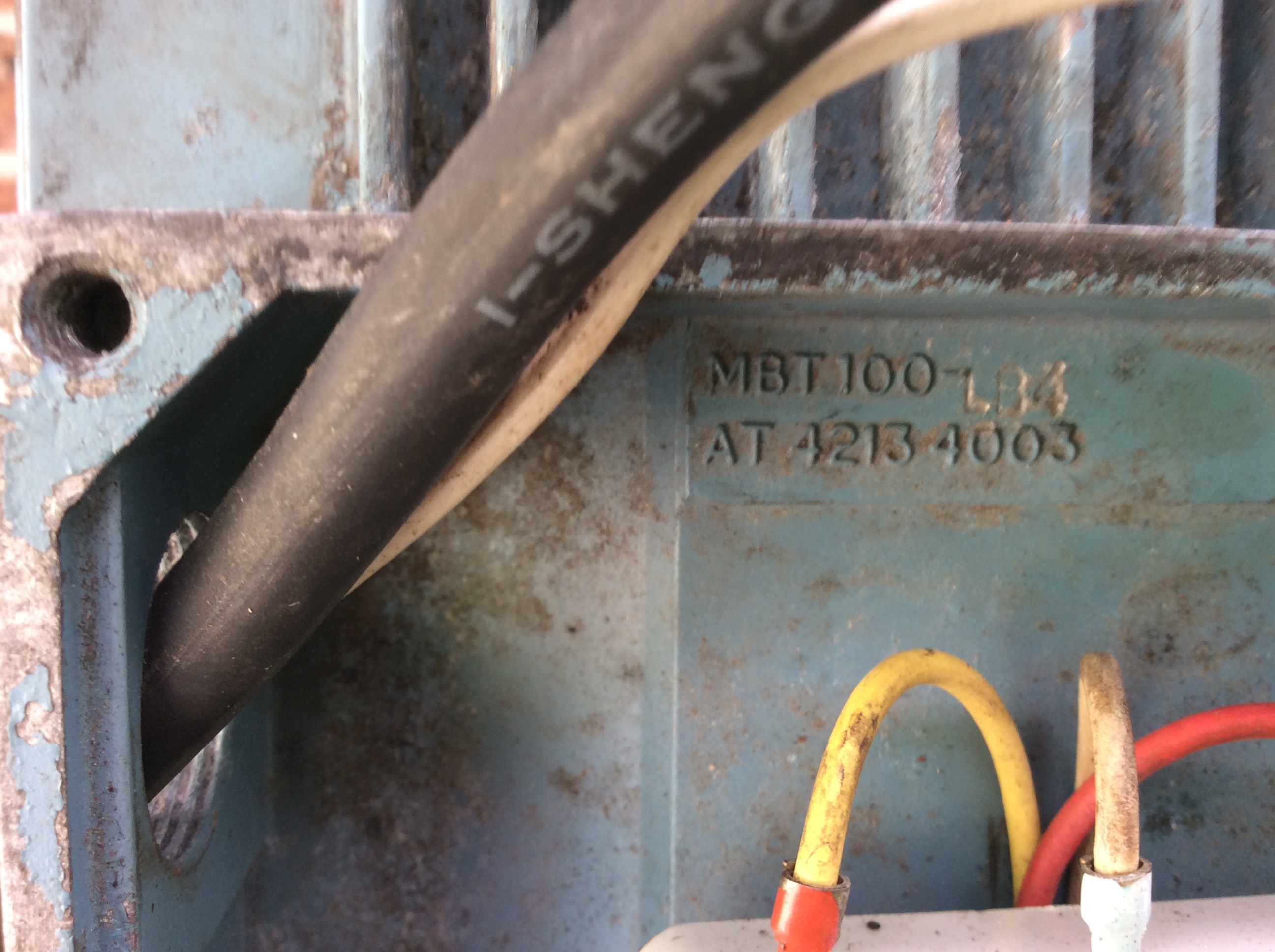

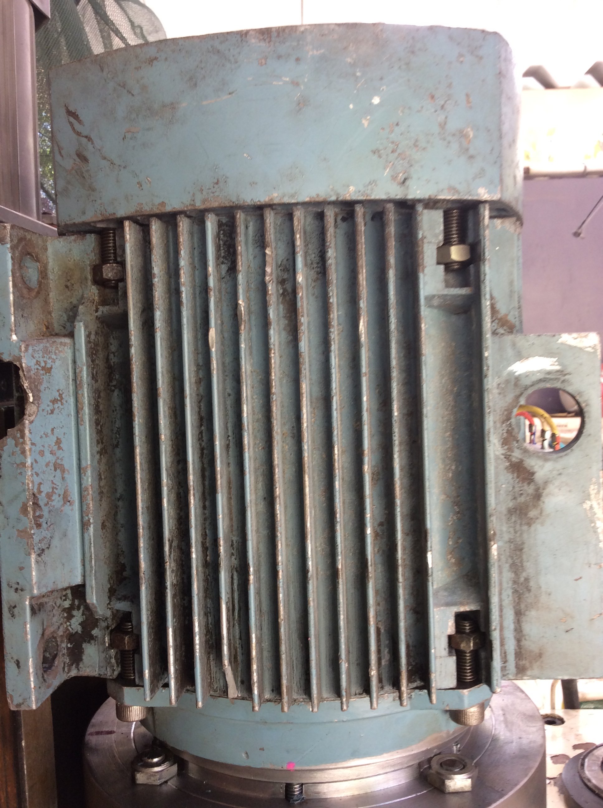

Looks like an Asea motor, hard to say the kw, cant really see how big it is.
Should say on the rating plate what the voltages are for star/delta, it could be that its meant for 440/660 instead of 220/440.
Seeing what it's attached to would be useful.
If you know what it did reverse engineering things to come up with the likely HP required to do it isn't that hard.
If its 1 hp or more I wouldnt advise you try and run it off single phase, esp if the load has a high start torque, unless you run it off a inverter drive or a rotary converter.
