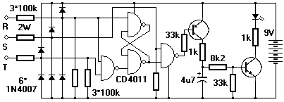

3 phase sequence detector
I use this cct.
