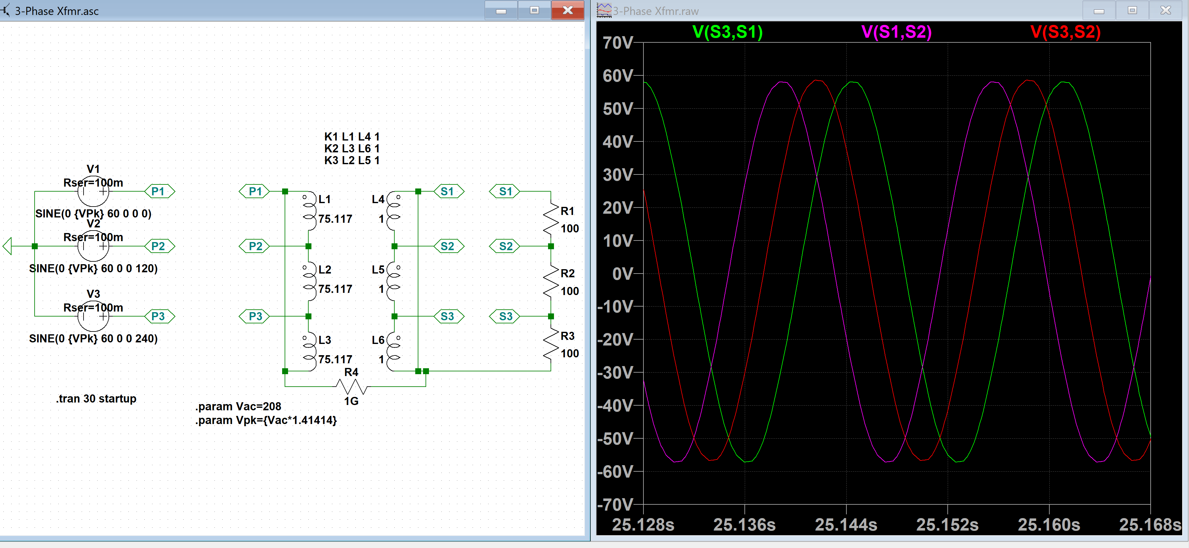

Hello, I need to simulate a 3 phase star-delta (Yd11) transformer in LTspice. Any idea of how can I proceed?

That would make a single phase transformer with six windings, I think. I would rather use three cores to make three separate transformers, but that I am not sure if it is equivalent to a single three phase one.Just use inductors L1,L2,L3 etc of appropriate inductance and winding-resistance value, plus the directive k L1 L2 L3 ..... = 1 (where .... denotes any further windings) to simulate an ideal transformer.
You could be right. That directive gives a net zero output from L4 if L1-3 have identical amplitude and frequency inputs mutually phase-sifted by 120 degreesThat would make a single phase transformer with six windings, I think.
You need a much higher inductance (a Henry or more) to reduce the magnetizing current to a more typical level at that voltage and frequency..Try this for the YD configuration :-
Yes, for real. I was just testing the principle.You need a much higher inductance
Isn't this a delta delta connection?It can also be done this way.
Just used "the square of the Turns ratio" for inductance values
