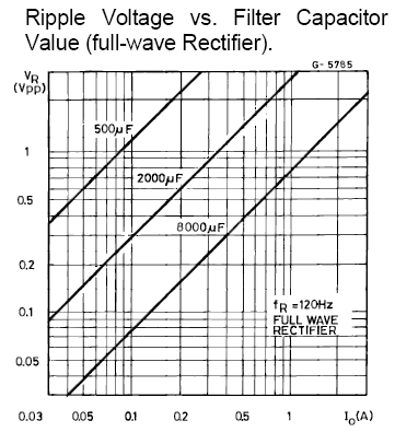

I was wondering if there is a chart around for ballparking Cin/Cout
values dependant on load..
I don't think it's too specific, as long as the capacitance is not too small and the equivelant series resistance of the capacitor is not too small it will be fine. Pretty much any capacitor you use should be okay (just don't go for a super small one or a high quality low ESR one).
One diagram I found used 100uF on the input and 0.1uF on the output, while another used 0.33uF on the input and 10uF on the output.
The datrasheet shows a 0.1uF capacitor on the output and recommends a 0.22uF on the input of a 78xx regulator if it is far from the main filter capacitor.
Here is a chart showing how much p-p ripple voltage there is with certain main filter capacitor values and load current:

If the Cin refers to the bulk filter capacitor that is intended to follow a 50 or 60 Hz rectifier then you might want to put some effort into estimating the size of Cin. If it is just the smaller capacitor that might be intended to reduce transients then I'd follow the manufacturer's datasheets, in the absence of better information.
If you are concerned about reducing the ripple or hum from an AC source you might consider that some of the 3 terminal regulators do suppress ripple. Paul Scherz "Practical Electronics for Inventors" has a page or two on this in a relatively easy to understand way. Electrolytic capacitors cost money and take up space - so an overly large capacitor might not be a good solution. If you do know something about the goal (ripple) then some design effort might result in a smaller but equally effective capacitor selection.

For DSA66 benefit - if we are talking about the big filter capacitor, note that a high degree of precision in calculations isn't a must. The bigger capacitors have quite the wide tolerance and if the calculation is important you might want to use the lowest value of capacitance expected. Now, if you have capacitors on hand that are much larger in value then within limits, use them. Less ripple is usually not a problem. At some point the current demand to charge a large capacitor can momentarily overload the circuit supplying it but that's also manageable.
Very large capacitor values can also cause the rectifiers' peak instantaneous current rating to be exceeded.
