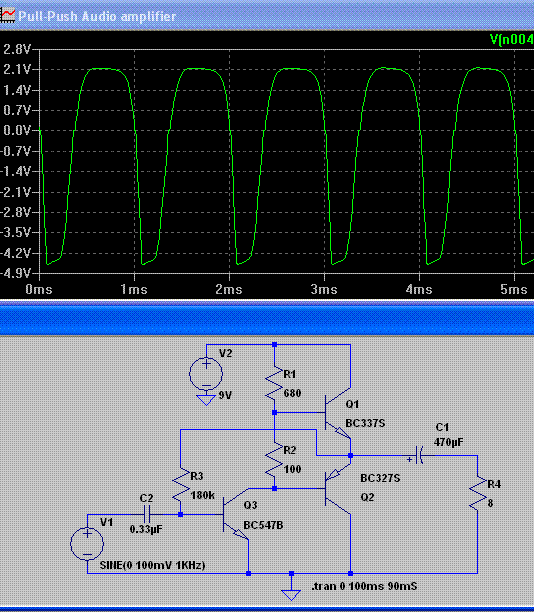

I found a professional computer audio amplifier made by China. When I opened it was amazingly simple. So I listened the output audio performance carefully and heard distorted audio. It was not playing clean audio like an audio amplifier chip plays. However its simplicity and loud audio is impressive.
When I made a simulation, I saw huge distortion. Here I have attached a simulation file (.asc) for LTspice.
In the next post (#2) I have uploaded screen shoot of the simulation. So please observe the files and suggest me to reduce the huge distortion. I changed some components but not being able to decrease distortion.

Here is a screen shoot of the simulation. Huge distorted waveform fo the audio amplifier. (I posted this 2nd post too because I cannot upload multiple files from my java cell phone browser.)

I guess that the design objectives were:
1 Make it as cheaply as possible
2 Have some sound come out of it
3 Make it as cheaply as possible.
It looks like the cost of components and board stuffing labour for that thing worked out cheaper that say an LM386 which would (probably) have less distortion.
At 1 kHz, the .33 uF capacitor has an impedance of 483 ohms. Tis is too small givn the size of the feedback resistor, 180 K. The circuit has too much gain. To correct this, insert a 300 resistor in series with the .33 uF input capacitor to reduce the gain, or connect the input to the wiper of a pot to reduce the input. Either of those methods should eliminate the clipping.
Other than that, there is not much you can do, The output transistors are driven by an asymmetrical impedance, with the transistor pulling down and 680 ohms pulling up. Increasing R2 from 100 to 200 will decrease the crossover distortion but increase the static current through the output stage.

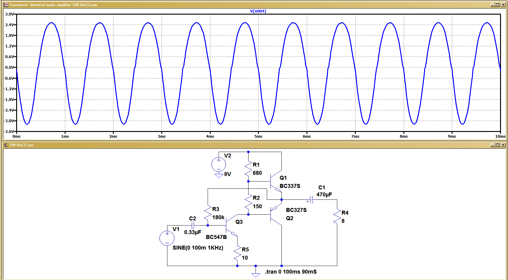

Hi Willen,
All it needs is an extra resistor 10R and change in value from 100R to 150R and its almost acceptable.
E

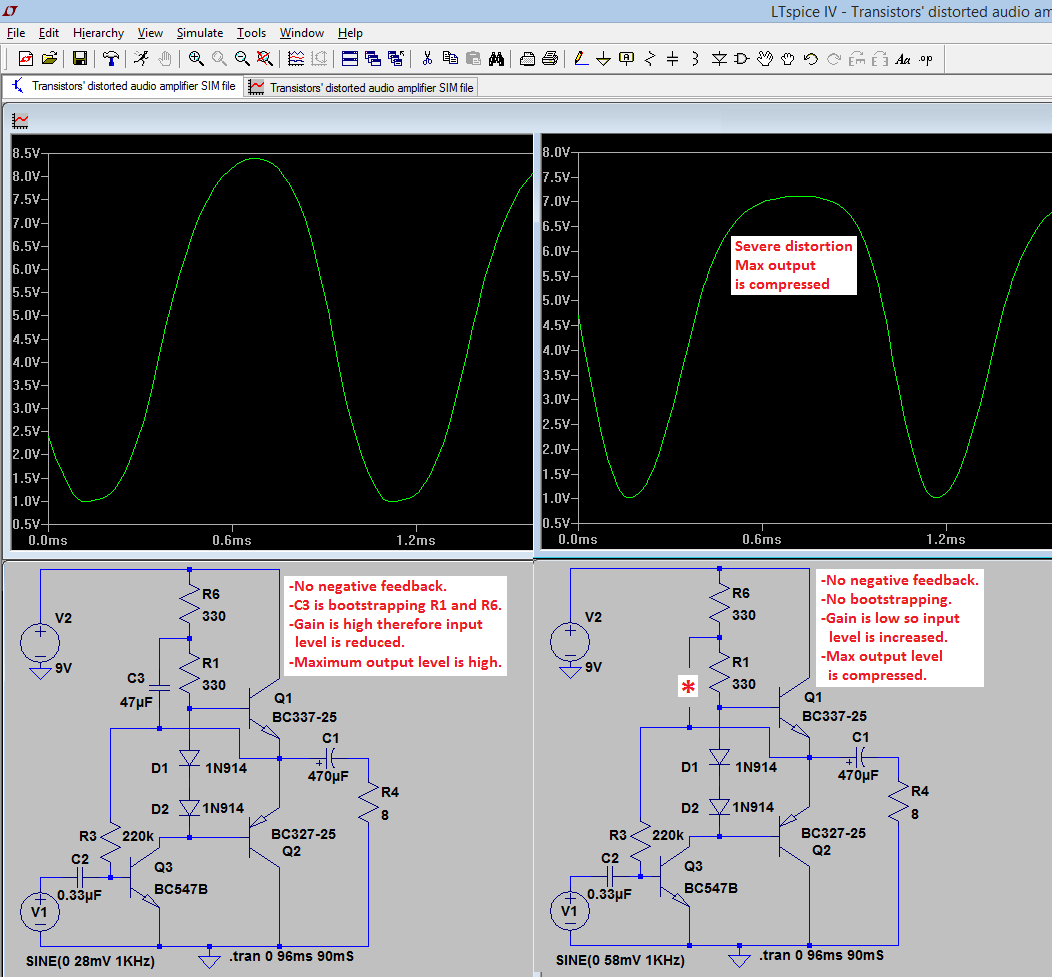

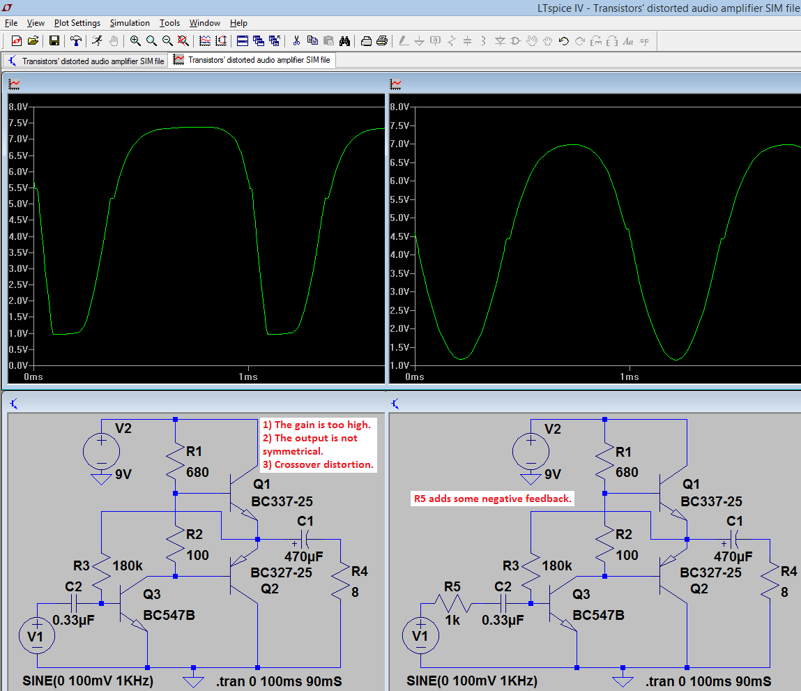

I fixed it:
1) The sim has a signal source with ZERO ohms output impedance that shorts AC negative feedback from R3. I added R5 as 1k then later changed it to 3k ohms to reduce the gain and distortion.

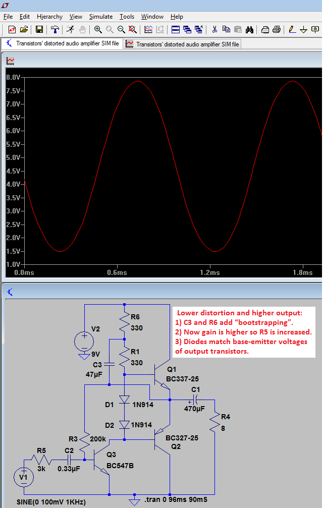

2) I changed R2 to two diodes that match the base-emitter voltages of the output transistors.
3) I added bootstrapping with C3 and R6 to increase the gain and maximum output level.

The trouble is you are "pulling down" the push-pull output with a capability of a few ohms (via the transistor) but pulling up via 680 ohms.
This gives an uneven output, even though the first transistor is producing a fairly good quality signal.
There is nothing better you can do with just 3 transistors.

You're not checking the correct type of bootstrapping, it considerably increases power output and considerably reduces distortion (by greatly increasing base drive capability of positive going signals). A similar technique is to replace the top resistor (680 ohm) with a constant current source.
I'd also like to see some emitter resistors on the outputs, to prevent thermal runaway - and on that line I wouldn't use two diodes, I'd use a fourth transistor as a Vbe multiplier.
It does indicate that it adds distortion though
My circuit uses bootstrapping to increase the output impedance of the voltage amplifier transistor and allows its output to swing above the supply voltage with fairly good linearity. Good linearity is low distortion.
The bootstrapping capacitor C3 causes a constant current in R1 so that the impedance of R1 is very high increasing the gain and allows the base of Q1 to swing above the supply voltage.
Look at the voltage amplifying transistor Q3 without bootstrapping then with the bootstrapping.
Colin, adding bootstrapping makes the simple 3 transistors amplifier work VERY WELL, when it also has negative feedback..
