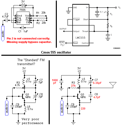

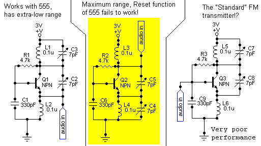

Take a look at these transmitters. I have built each one of them and the results are shown in the attachment. The middle one seems to work the best if the RESET pin of the 7555 is tied high.
BUT, I want to make a transmitter that can transmit a tone, just by making something positive or negative. And it looks simple with the 555, but it is more complex.
What I want to do is take the output from a 555 timer, and drive it into a transmitter, and produce a long range transmission. I hope to have over 60 feet.
My other design I published on here works fine, but it is not compatible with my receiver. In other words, if I used the exact same capacitors for tuning in both the transmitter and receiver, the published design will not work with them.
Please help.
and I'm not joking here!

You don't have the Cmos 555 oscillator wired correctly.
Your FM transmitter's transistor has such a high base current that the transistor is always saturated.
Supply bypass capacitors are missing.

You know what, I drew the 555 circuit wrong. I was thinking too fast. I meant to direct connect pin 2 to pin 6 and connect a capacitor between pins 2 and 1.

I guess that means my long-range circuit (in the middle) is almost always under saturation. The audio is connected to the collector of the NPN.
I can't connect the audio output to the NPN's base because 1) I'm asking for inversion, 2) It will jeopardize the frequency of the transmitter portion set by the 330pF capacitor and the 4.7K resistor, and 3) the gain is lower.
I'm ok with heavy saturation, because I want the signal to get through. As I said, it works great when the reset pin is connected to +ve. When the reset pin is connected to -ve, it doesn't work. Sometimes, the wrong audio tone is emitted!
Also, I am using 47uF battery coupling capacitors, and it even does not make a difference.
A 555 oscillator oscillates when its reset pin is at +ve. It is reset and won't oscillate when its reset pin is at ground.

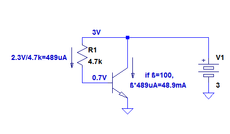

With a 4.7k base resistor, a 3 volt supply, and a beta of 100, collector current will be about 50 ma. This is the absolute maximum collector current for this part.
I don't understand how you got about 50ma. According to my calculator,
3V / 4700 ohms = 0.000638298 amps
which is 638uA, going from +ve to NPN's base.

For now, I'm just gonna address the BJT current issue. The little schematic below should explain it. This is not a simulation. If the beta is not 100, the collector current will be different, as shown by the equation.
Between yesterday, and today, I kind of figured it out. Thanks for clarifying it.

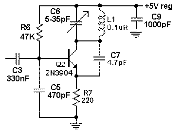

A resistor is connected from the transistor's emitter to ground as negative feedback to iron-out the huge difference in current gain of transistors.
If the transistor's gain is low, then less voltage is developed across the emitter resistor so its base and emitter-collector currents are increased. If the transistor's gain is high then more voltage is developed across the emitter resistor so its base and emitter-collector currents are decreased.
Most little transmitters use a 220 ohm emitter resistor but 100 ohms would have less loss.
My transmitter uses a 2N3904 transistor with a typical current gain of 220, and uses a regulated 5.0V supply. Its average oscillator current is 8.8mA.

That represents a variation of one of the most advertised transmitters available for anyome to build.
I do have some problems with it.
#1. I cannot get exceptional range like I can with mine.
#2. Most transmitters that are available to build insist that the antenna should be used at the collector. The problem is that it functions as a nearby hand detector instead of a decent transmitter. (it changes frequency when the antenna is close to being touched by your fingers)
#3. the 220 ohm resistor is a big problem to me. When I started with transmitters, I used the design you showed, and nothing came close to my recent design in terms of transmitter range.
Basically, the only BIG difference between your posted design and mine is that the emitter and collector pins are swapped, and input is injected into the collector.

MStechca's transmitter has its tank as its emitter to ground resistor. Therefore the antenna can't have a voltage swing that is much higher than the supply voltage which results in a high RF power output as occurs when the antenna is connected to the transistor's collector.
Also, the tank is trying to be a high impedance parallel-tuned circuit, but it is in a low impedance emitter circuit so the frequency stability of the oscillator is probably very poor.
