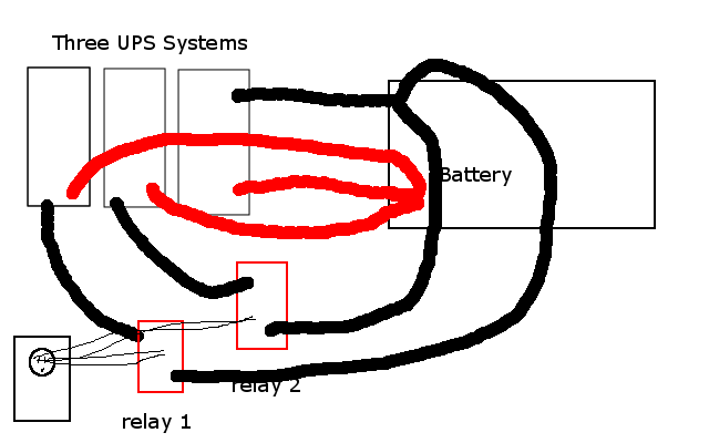

Ok, lets see if I'd got your ideas:
Uploaded with ImageShack.us
Is this correct?
So, the NC relay would inmediatly switch from battery to normal power, and from normal power to battery (like some kind of true XOR - exclusive OR - )?
Is this switch fast enought to prevent power failure to the computers?
Wich are the caracteristics of the NC Relay that I need? is it Ohms? Watts? Volts?
No. You need 2 relays. One for each UPS that will NOT BE charging the battery.
The relay will go in between the UPS and the battery on the battery connection cables.
This way, while you have AC-mains power, the relays will be OPEN and separating the 2 non-charging UPSs' from the battery.
As soon as the power goes out, both relays close and allow the UPS's to do their jobs.

This is how a 3 TYPICAL UPSs' could be done:

Would there be any problem if the UPSes try to charge the battery and the NC Relay make them to suppose that there's no battery? If a UPS is not in contact with it's battery it would not even turn on...
You just need one DPDT relay.
True.. I dont know what I WASNT thinking.. Thanks for the catch.
@FPLenin, there May or may not be a problem with the UPS's not seeing the battery during charge, but there is an easy way to check.
Go to one of your UPS's while it is charging. Pull a battery cable. What happens? This will be the same effect as using a relay.
I'm thinking of just adding a battery charger specific for the battery and isolating each UPS with a schotkey diode. That way the battery charger does what it's expected to do and the UPS does what it's expected to do.
It's possible that the UPS could get upset and say the battery isn't charging or some such nonsense. You could try a few diodes first without investing in the battery charger.
