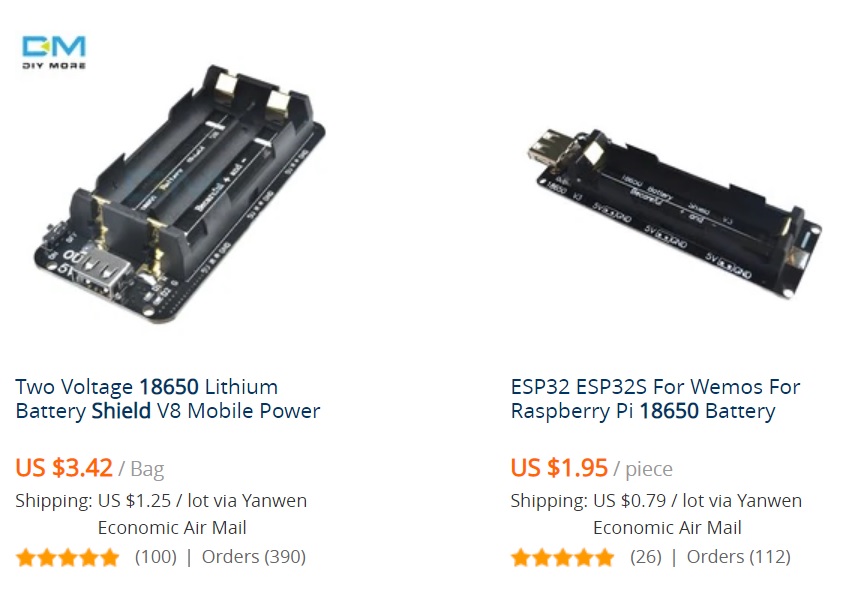

I purchased a couple of these single 18650 modules last year (see below) which include charger and BMS circuitry as well as 3.3v and 5.0v outputs. The outputs operate fine while charging, too. I'm so pleased with these modules that I just ordered a dual 18650 module to try out.

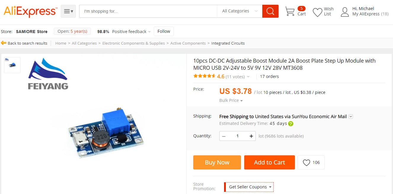

As for supplying 12 volts, I've been very happy with the little boost modules shown below.
Search for these items on AliExpress or Ebay....
