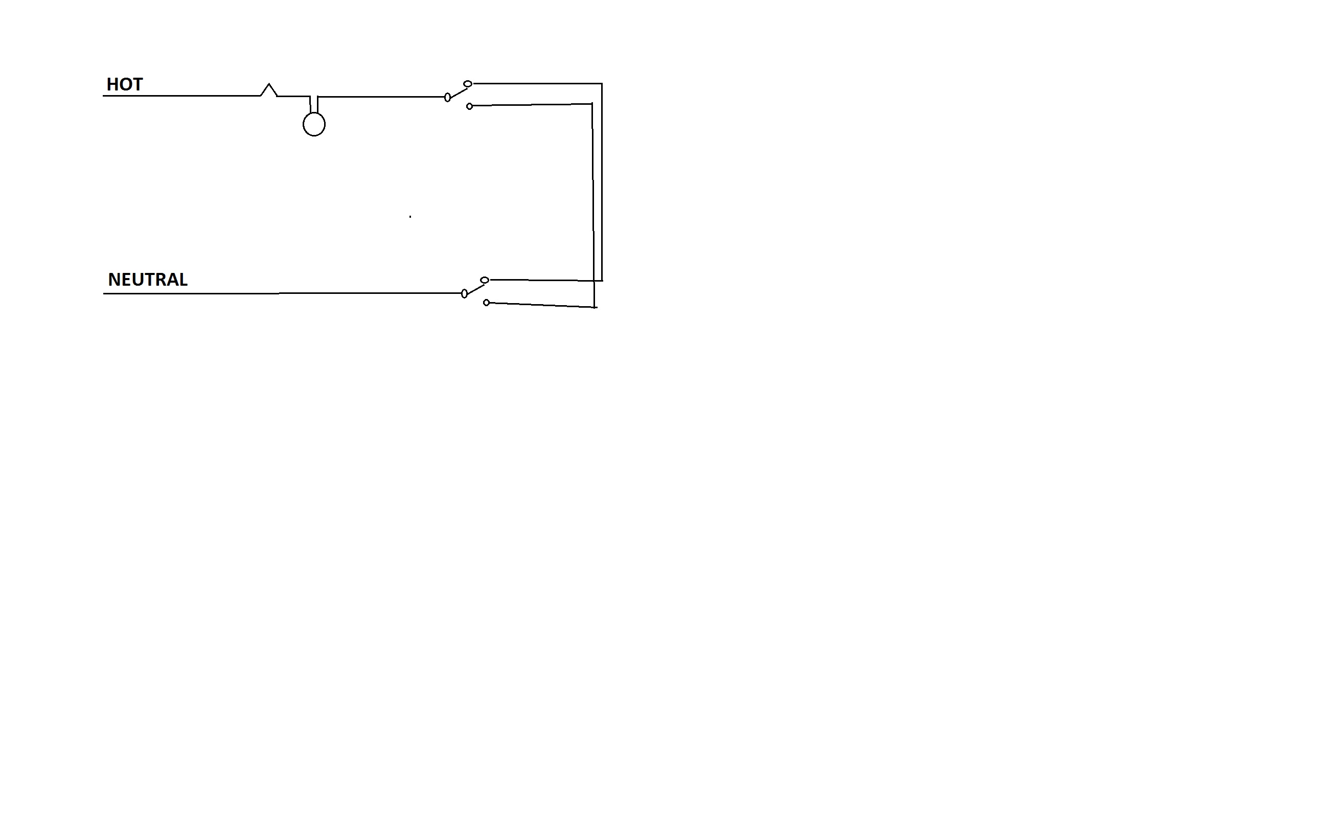

I just had a 3 way switch fail. There are 2 switches that control a light on the second floor. The first floor switch is a modern 3 way. The failed switch, on the 2nd floor, is an old hubbel rotary made before 1904. Both switch boxes have 3 wires as follows: first floor has 2 travelers and one neutral to ground. I checked it with my meter and it is the only wire, in either the 1st or 2nd floor boxes, that shows the black wire at the light fixture is the 120V power from the source. The 2nd floor box has 2 travelers and third wire which runs from the white wire at the light, where the hot black wire is located. There are no other wires at the light fixture. I have been searching the web but have not found an example of my wiring. I am hoping someone can help with this wiring problem.

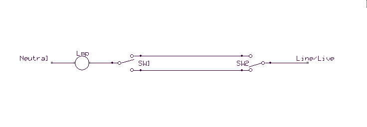

This image is the usual connection way for stair way lighting switch wiring.
Sorry, site software will not allow me to upload my GIF or PNG drawings.:(

I am assuming you are wired like this. Very bad. The hot and the neutral are switched. You should never switch the neutral.

Your drawing has captured the layout. It has been, working, like that for about 110 years. As your sketch shows, the hot line from source goes to the light's center connection and, the white wire is connected to the light's side/neutral connection which somehow ends up being the wire connected to com on the first 3 way switch. Why is this bad and does it violate the electric code in Ct?

It's bad Because if you switch neutral, the circuit is still "hot". If you touch any part of the circuit (as when working on the socket or switch) and also come into contact with neutral, or ground, you can get zapped...or worse...killed by electrocution..:nailbiting:

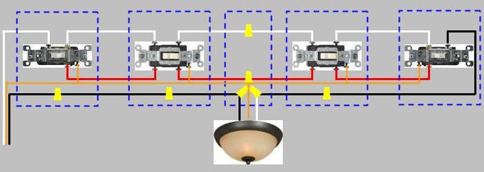

Here is the basic 3 way switch connection diagram.

Interesting/confusing national differences in terminology. The setup shown in post #6 would be called a 2-way system here in the UK. A 3-way system here has 3 switches; two end switches being SPDT and the intermediate one being a DPDT type.
That is an old one. Originally the neutral was switched and the device was "hot". This allowed the electrician to test the circuit by just apply a ground. As others have stated this was changed for safety reasons. Anyone know when?

Here , and in the U S , that would be a four way . That is 2 3 way switches and 1 4 way switch.
With this system you can switch from many locations !
Retrying the image upload from Post #2
E
