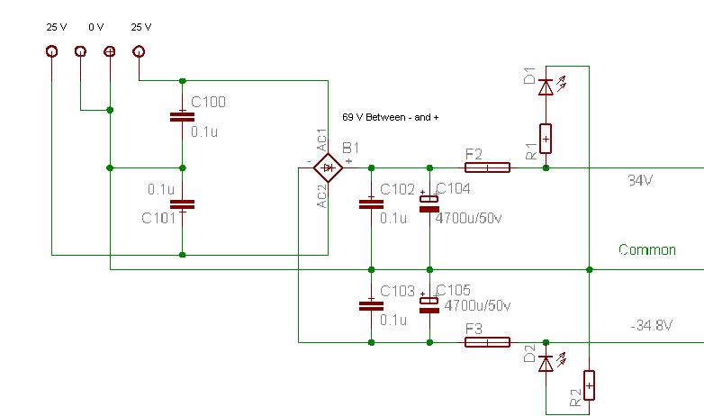

I'm just doing an alimentation of 30 volts. I looked for a regulator like 78xx series but it doesn't exist in 30V. So, I search for new ideas of design of a 30V regulator. I know the very simple regulator based on a zener diode and a transistor but I don't know if it works well at 30V and what's the power in the zener (I have only zener of 5 Watts).
My input voltage is 34,8V. And I need also a -30V from a -34V input.
The power needed is over 5 to 10 W.
Thanks in advance for your answer(s).

I think you need to give more details, if it's a 50V transformer with a bridge rectifer the output will be near 75V. If it's a 25-0-25V transformer with a full wave rectifier (two diodes) it will give 35-37V off load.
If it's the second option, a 25-0-25 transformer isn't really high enough to regulate down to 30V - under load the output from the rectifier will tend to drop below 30V to start with.
I give you the schematic. It will be more easier. :)

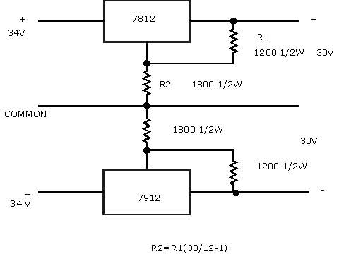

You can use a couple of 12volt regulators with external resistors to set the voltage to 30V. Here is a schematic.

The transformer is really too low a voltage to give a regulated 30V supply, you really need something like a 32-0-32, or as an absolute minimum 30-0-30.

Another common way with the 78XX and 79XX regulators is to stick a zener in the ground lead of the device. This will lift the regulator's fixed voltage by the zener voltage.

The voltage that you have measured is the "no load" voltage, which is about 1.4 x the transformer voltage (25 x 1.4 = 35 volts).
This voltage will be a nice smooth DC voltage,
BUT,
as you start to put some load on the supply and take current from it, you will get some "ripple".
The ripple will give voltage dips every 10 mS, (assuming a 50 hz mains supply).
For a capacitor filter power supply like yours, the magnitude of the ripple can be estimated from the equation:
Ripple Volts = (Load Current x Ripple Period)/Filter Capacitance
So in this case, if you have a 1 amp load (maximum for a 78xx regulator), the ripple will be:
ripple = (1 x 10 x 10^-3)/4700 x 10^-6 = 2.1 volts
Which means that the input to your 7812 will be varying between 35 and 32.9 volts.
If you are going to take less than 1 amp from the supply, the ripple will be less.
You could reduce the ripple by increasing the value of the smoothing capacitor, say put another 4700uF in parallel with the one you have at the moment.
The mains voltage may be low, (everybody cooking their christmas turkey!), so you will have less voltage from your transformer.
etc, etc etc.
You may just get away with it if you are lucky, but this feels like a circuit which is on the edge of not working 100%.
